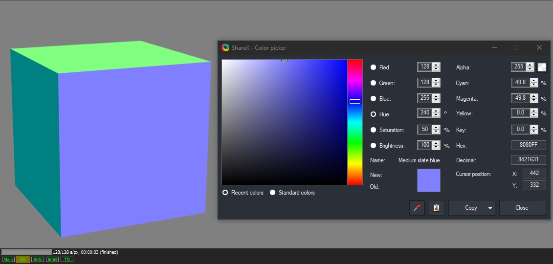

I'm trying to build custom normal maps. I got most of the steps down, but I'm noticing that the Geometric Normal pass seems to be displaying "neutral" blue as R:87, G:82, B:240 (#5752FO). From what I've been reading, neutral blue in a normal map should be R:128, G:128, B:255.
I've tried setting up a parallel camera to make sure this isn't a result of distortion or something like that - same result.
Is this a bug, or is there something I'm doing wrong, or does it not matter if the color is 128/128/255?

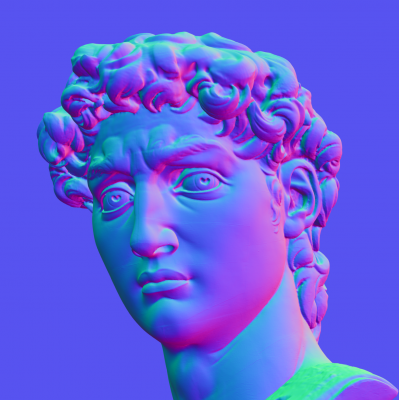

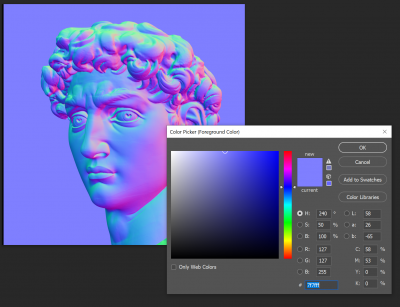

The resulting normal map, saved from the live viewer

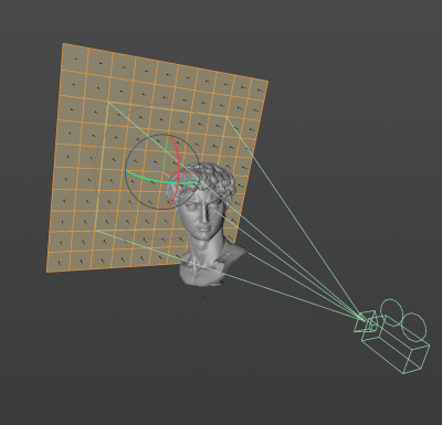

camera setup: plane is parented to the camera so it's being shown dead-on at all times.

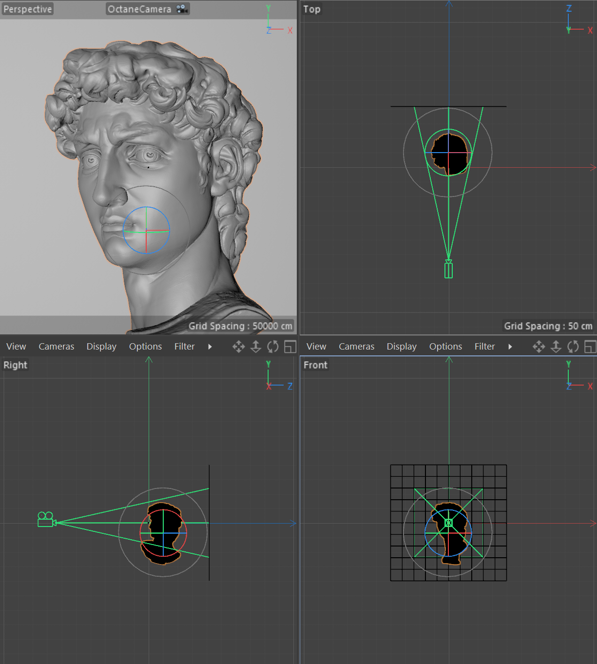

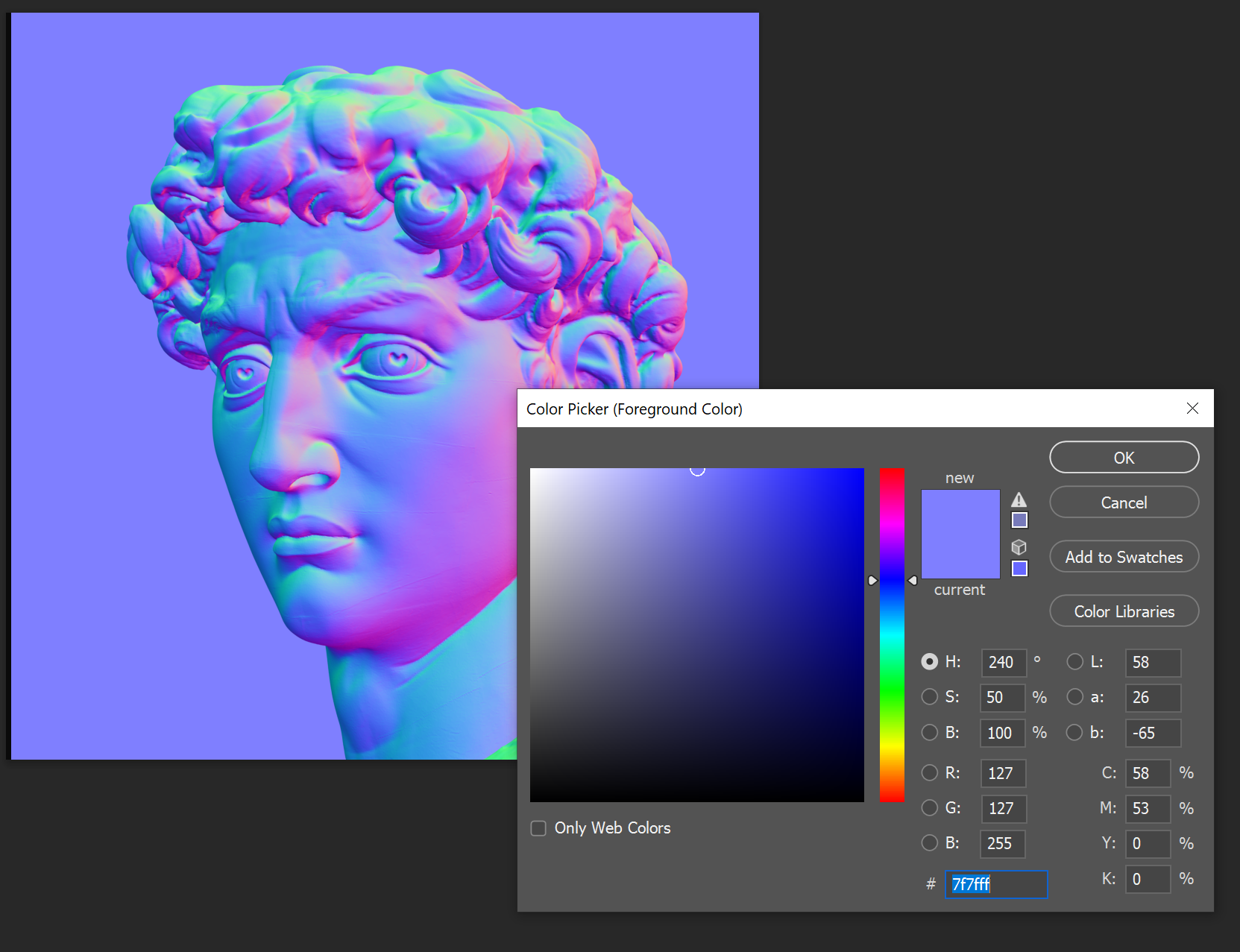

Camera-space vs. World Space was the missing component in my thinking. When I zeroed out the camera and put the background plane straight up and down along Y, I got the neutral color I was expecting.
I'll give the OSL texture a shot next to see how that differs. Thanks again!
