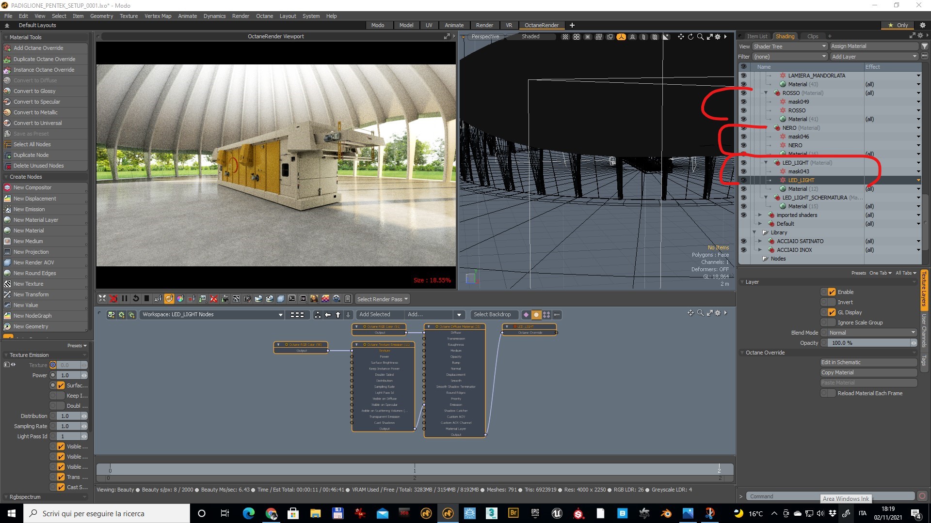

I have a scene setup of a set in Modo with Octane and everything is fine, but than when I
import an object (also prepared with octnae material in another scene) and i
renderit everything is fine, but I cannot edit the material of the imported object...
Even if I try the edit in the node editor option it fails...
I need to do some corrections on the material and I want to do them in the final scene as otherwise
i cannot fine tune the materials...
Any suggestions?

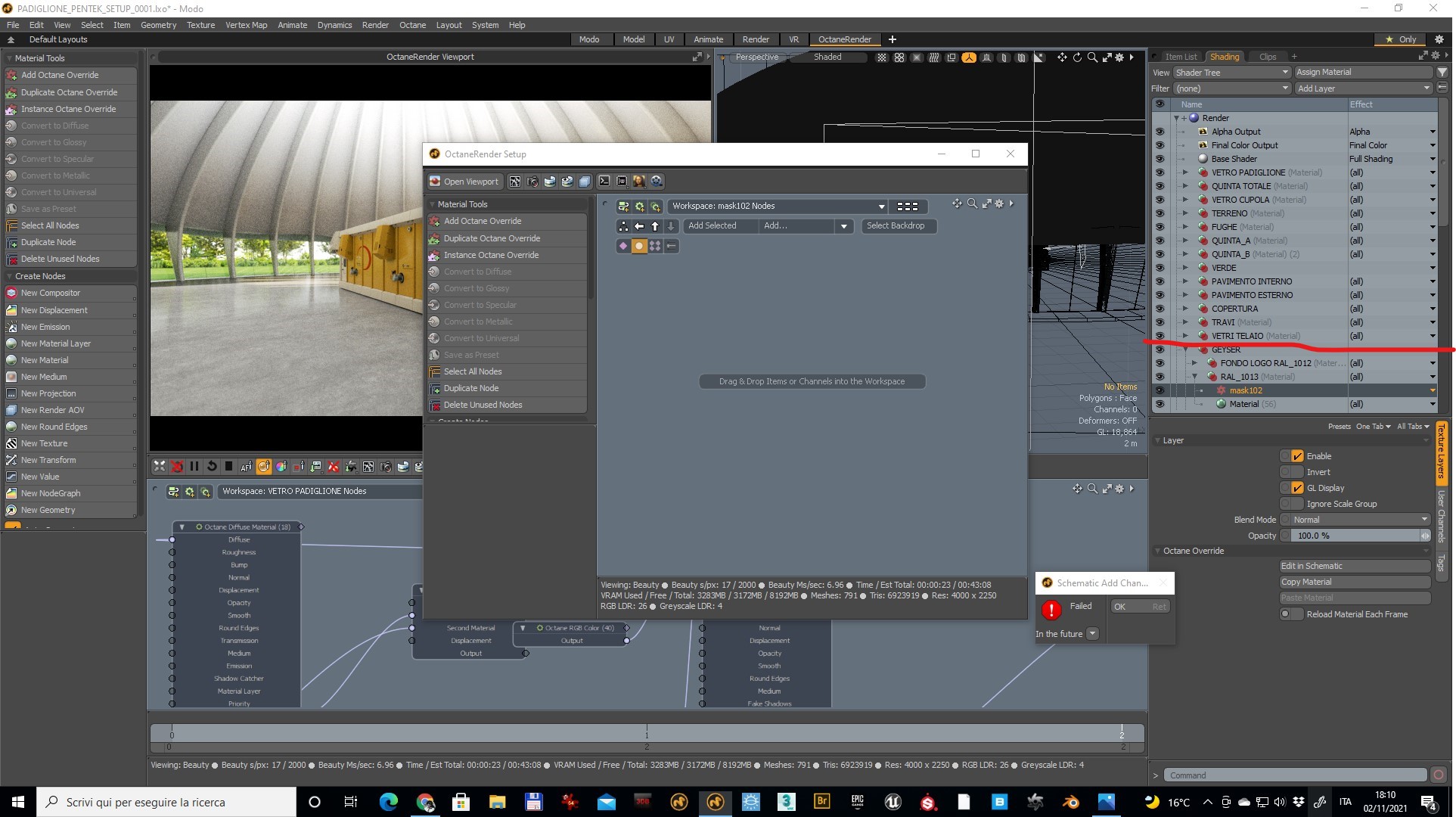

I uploaded a model in this set and its impossible to edit the Octane materials...
All the material below the red line cannot be edited..despite they are rendered correctly...
This is a big issue for me...
3dsign studio
Advanced visual communication
http://www.3dsign.it
spigolo
Posts: 292
Joined: Fri Jun 04, 2010 5:16 am
Location: Florence Italy
I'v found a workaround..to add a new Octane override, in this way I can edit materials but is
a bit stupid to have to do this on imported item...

Try importing the Modells with the import dialog. For some reason dragging and dropping from another scene does not work
spigolo
Posts: 292
Thanks!
I will try this way.
