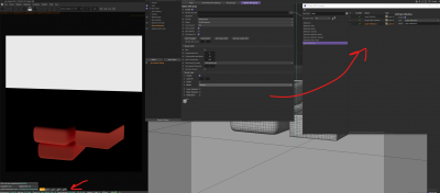

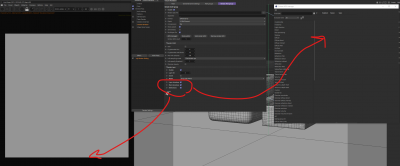

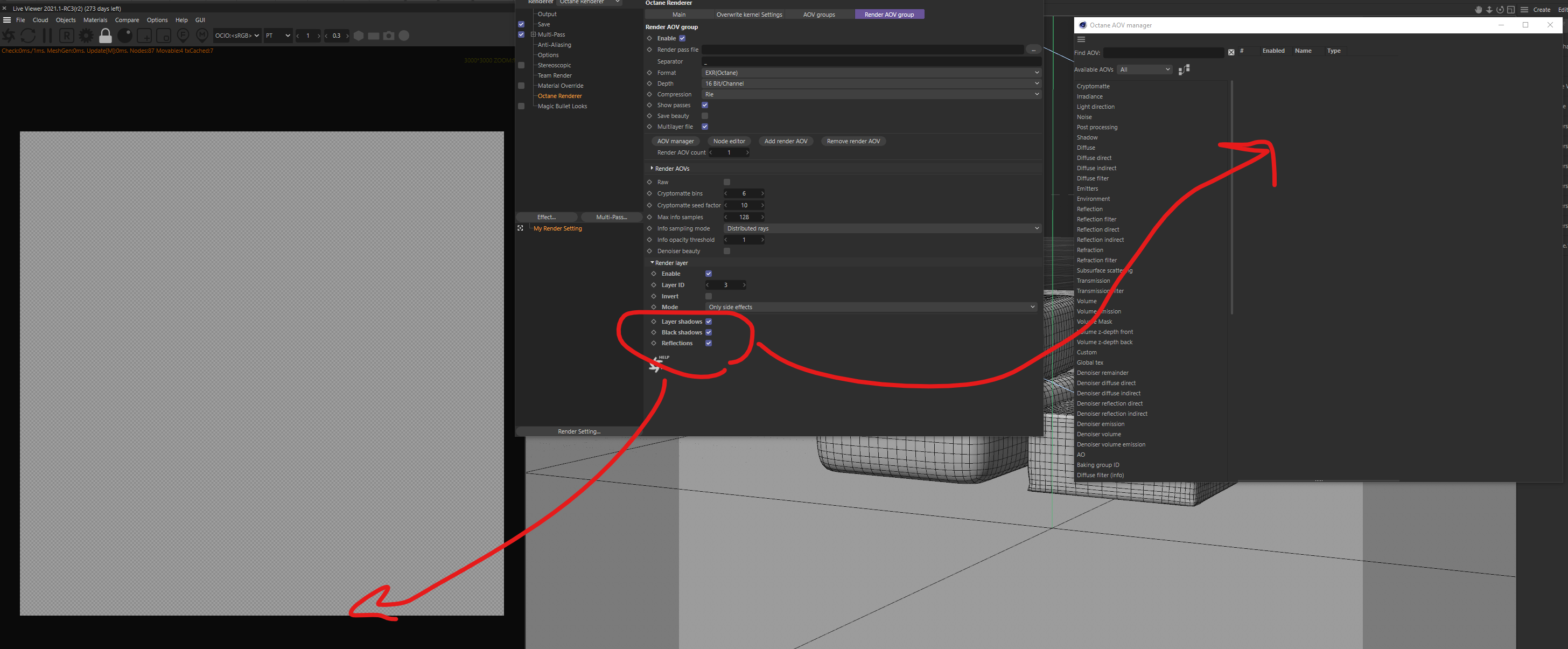

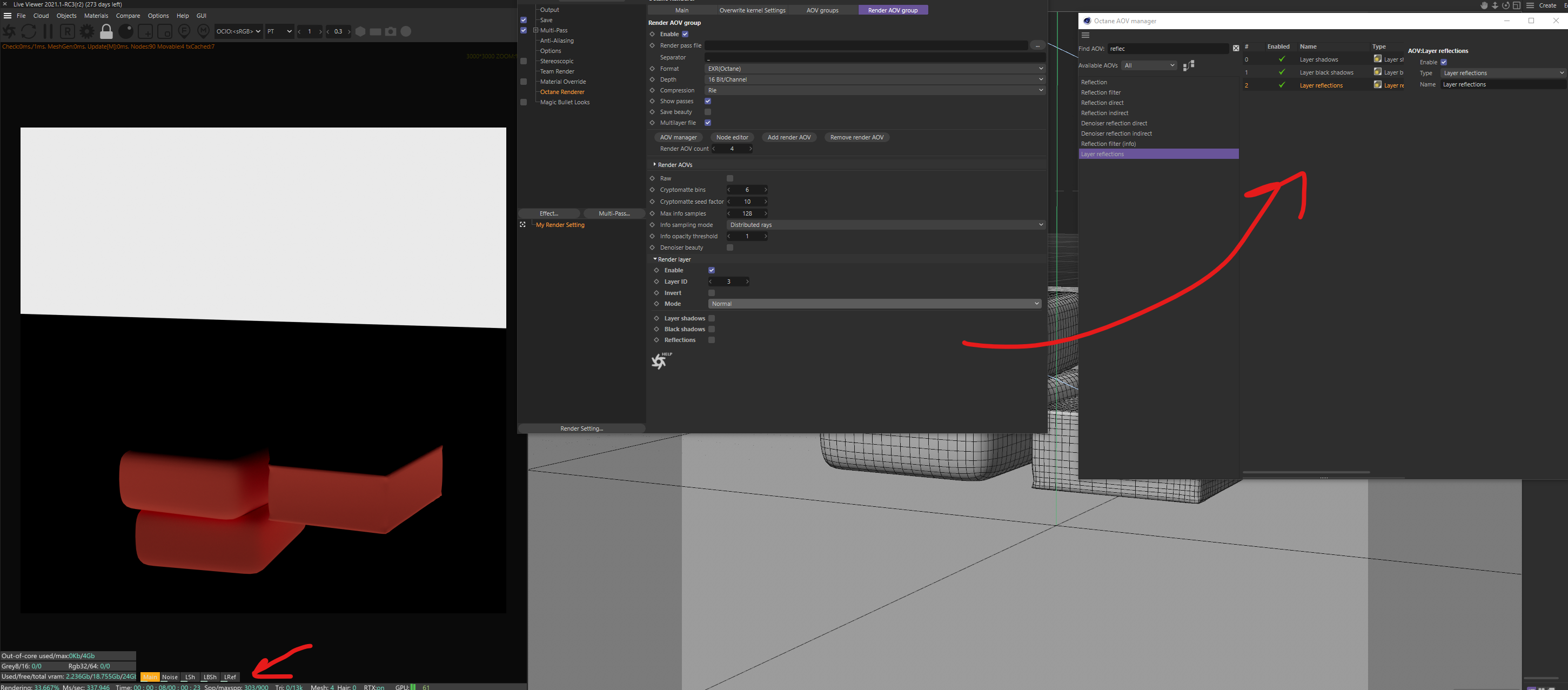

What I found today, if I use the side effects filter with render layer enabled everything goes blank, but if I use custom AOVs with the render layer for shadow and reflection I get separate passes for each and it works. Due to Octane pushing for a more robust AOV system is that option in the render layer panel in cinema no longer functional? I feel like it could still toggle and enable those render layer passes for Shadow/Black shadow/reflection without a manual AOV input for those. Not a huge deal but it's still there and not functional as it seems which is my point.
Please see the attached screenshots.

These parts are still wip on plugin side. I'll check it
