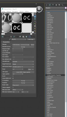

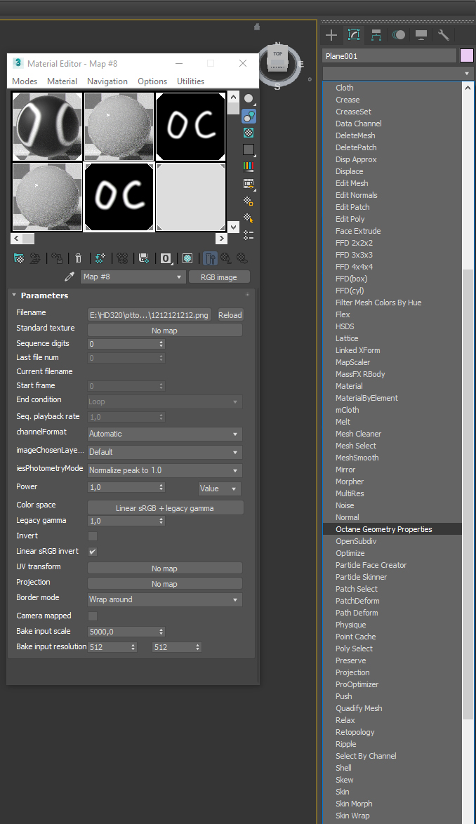

Hi yanchuangjie,
Try adding Octane Geometry proprerties.
Also using the rgb texture node like in the screenshot.
Regards
Paride

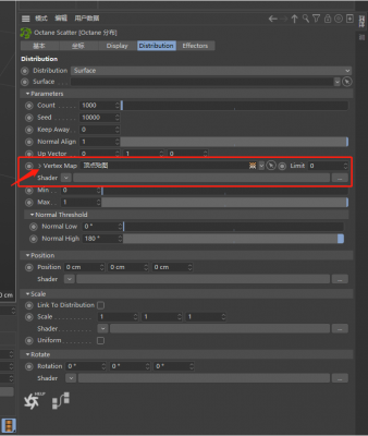

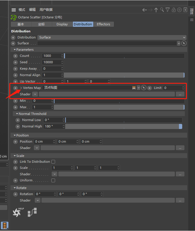

It means that vertex colors cannot be used to control the scatter surface density?
I want to use vertex colors to control the distribution of plants,it is inconvenient to use textures.
Is there a node like C4D?

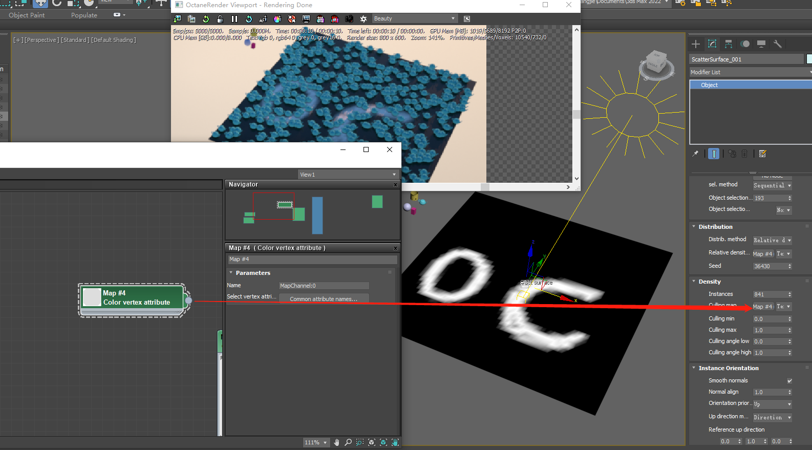

yanchuangjie
Posts: 12
Joined: Tue Feb 02, 2021 6:54 am
It doesn't work like this.

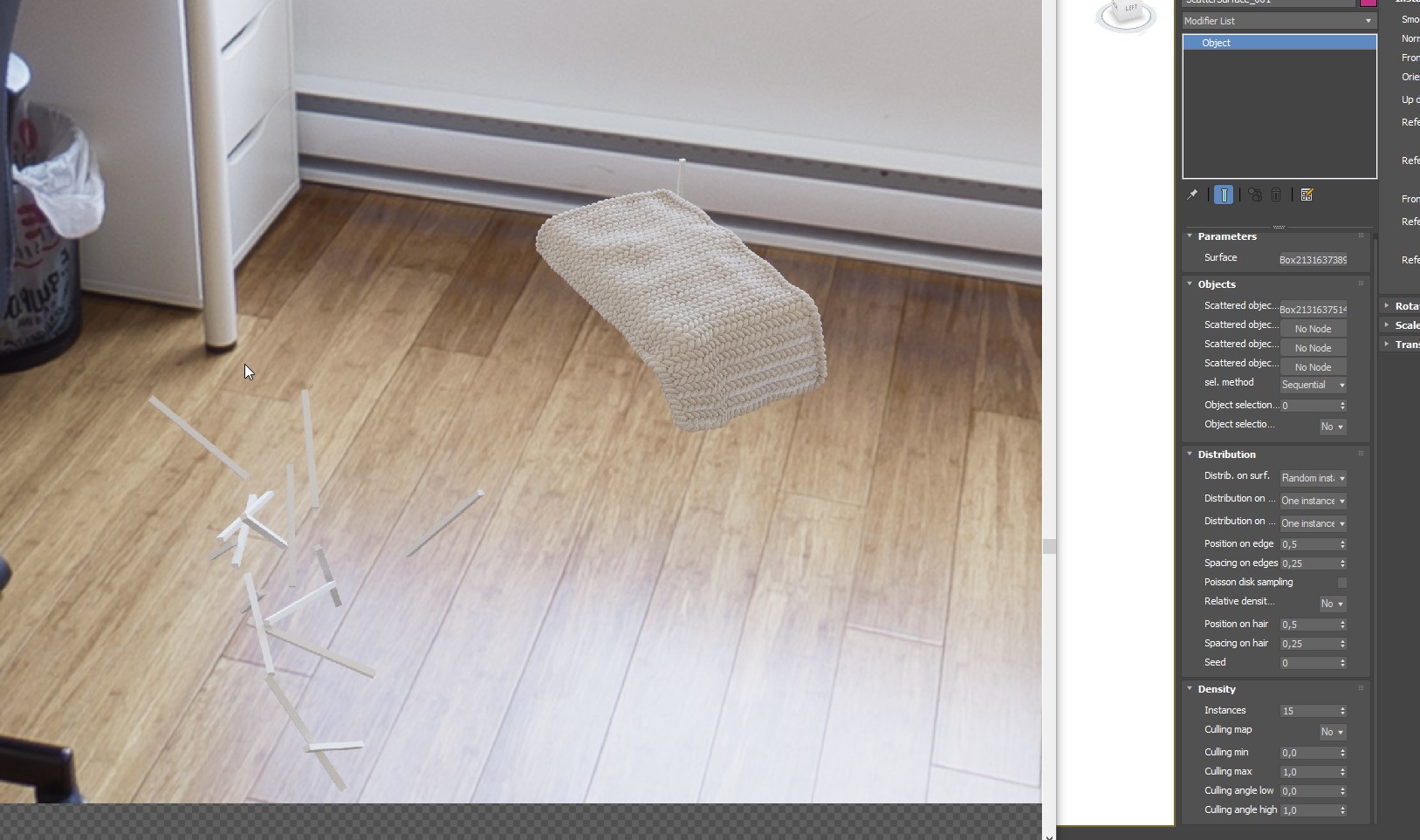

samsue
Posts: 393
but why aren't the objects distributed on the surface? they appear far from the object
