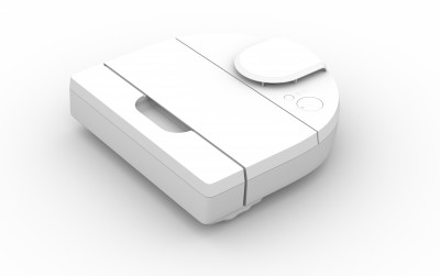

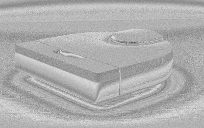

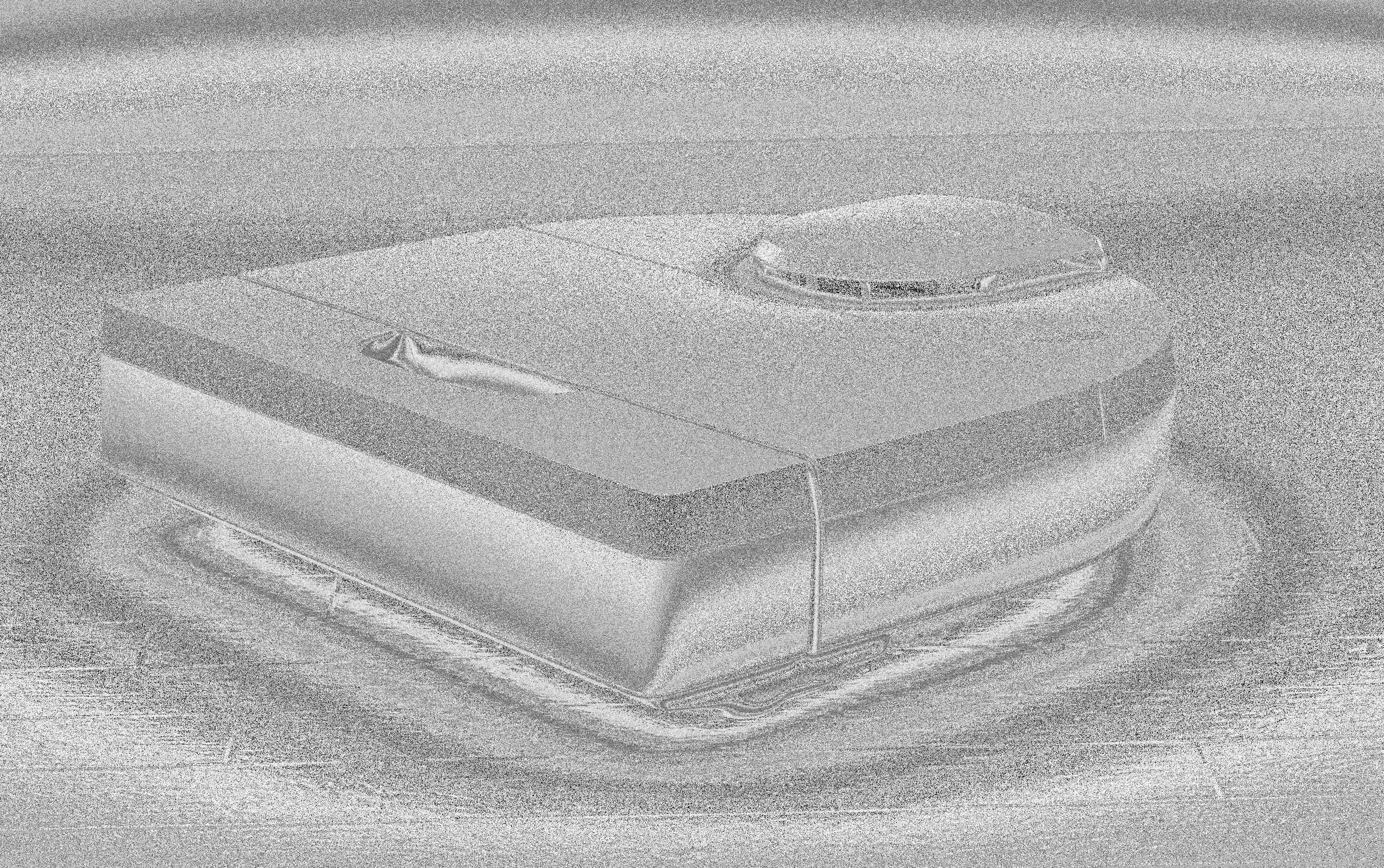

Hi All,
I have been getting a consistent failure when using an ambient occlusion pass. Does anyone have any idea why I might be getting these results?

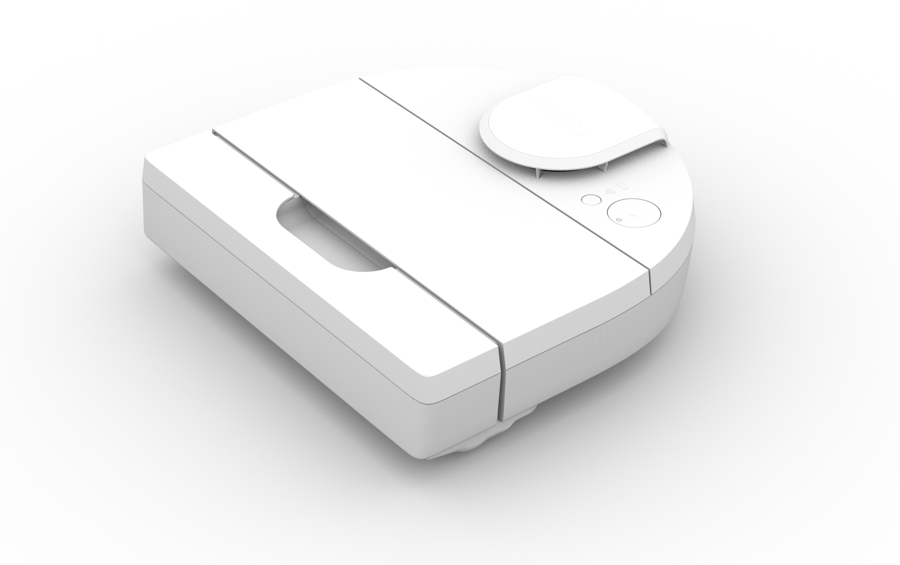

it could depends on Ray epsilon setting, try reducing it to 0,001 but make sure you are using the correct unit of measurement.

Thanks, that seemed to work. I have had that problem several times in the passed with other versions of the plugin, and Im sure others have also.
