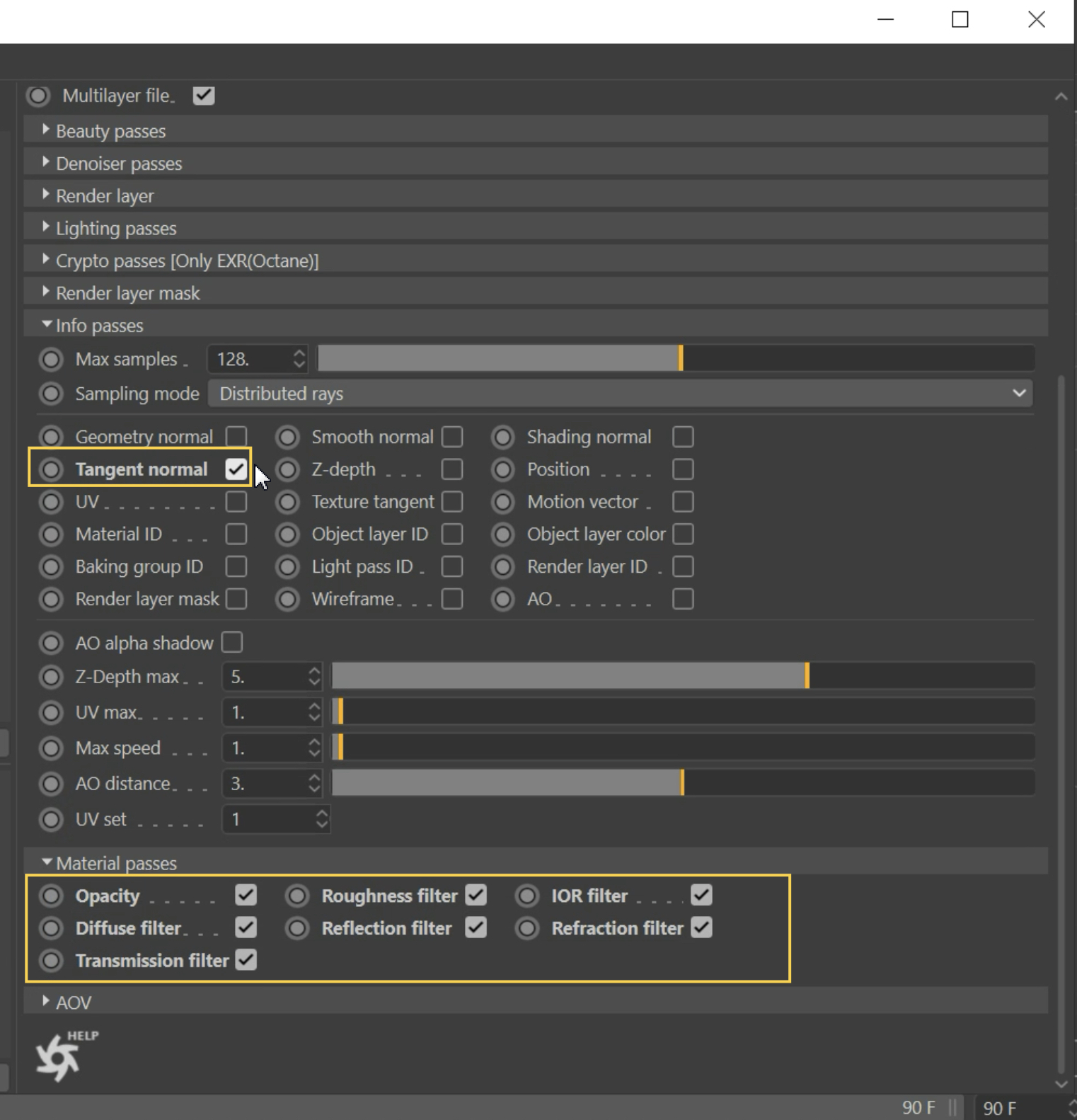

you can obtain all the desired passes via Material passes, with the exception of Displacement, but you can obtain a Tangent Normal texture of it:
https://docs.otoy.com/cinema4d/MaterialPasses.html
https://docs.otoy.com/cinema4d/BakingCamera.html
