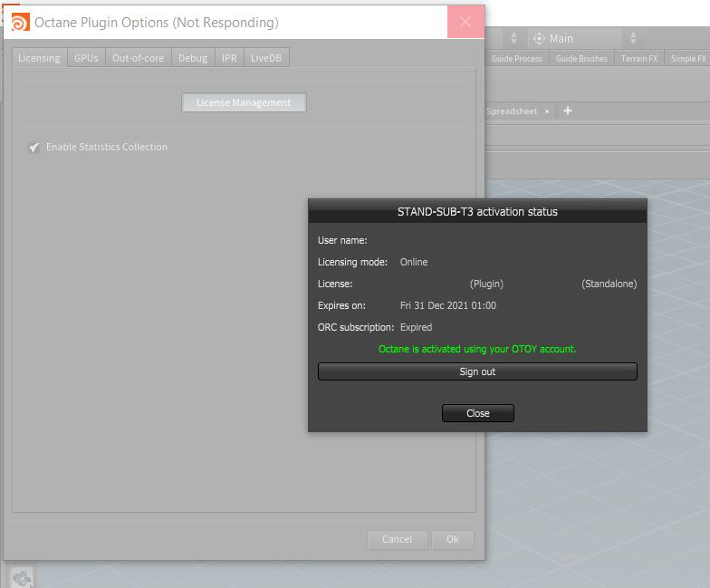

Hi
Thanks for your reply. now i do not have the error anymore, however, while trying to get the license management window inside houdini - it returns with "no response" and eventially crashes:
https://imgur.com/DWpWiaN

Houdini is frozen while the licensing window is open. Are you sure that you don't have the licensing window behind the Houdini window?
About the licensing release problem, this can happen if Houdini crashes without releasing the license. To release the license you only need to open Houdini in the machine where the license is locked and render something. After a clean exit, the license should be released automatically. You also have an hscript command to execute from hython that should release the license, but always using the terminal and from the system that has the license locked.
