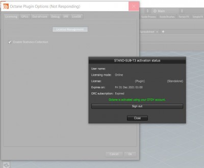

Houdini is frozen while the licensing window is open. Are you sure that you don't have the licensing window behind the Houdini window?
About the licensing release problem, this can happen if Houdini crashes without releasing the license. To release the license you only need to open Houdini in the machine where the license is locked and render something. After a clean exit, the license should be released automatically. You also have an hscript command to execute from hython that should release the license, but always using the terminal and from the system that has the license locked.

Okay i was able to log out of houdini in win10: https://imgur.com/KpIJ8DJ
however it still shows its using the license. is there any central way to make sure to logout entirely from a machine before shutdown so it releases the license in all plugins/apps? I have no idea why it is still showing active status.
