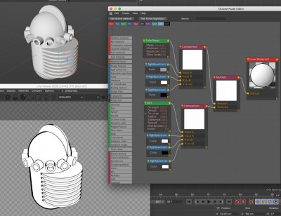

Outlines in the Toon Shader

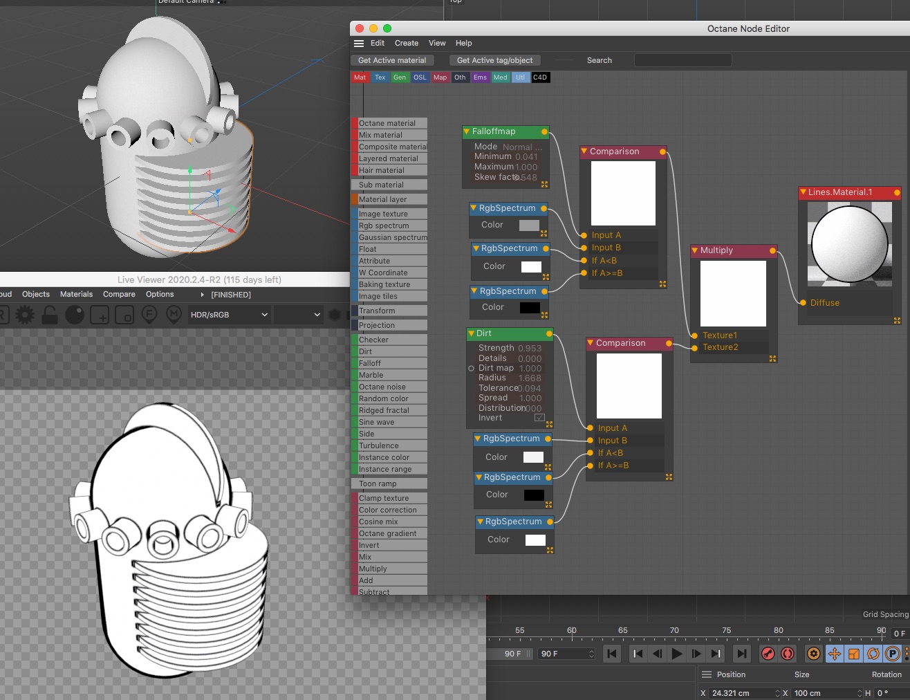

Here's a semi-decent solution that I think I picked up on the Live DB a couple of years ago. You use a Falloff node for the outline, and a Dirt shader for the interior lines. Run both of them through a Comparison node to make sure you get clean, black and white lines, then multiply them together. Then render using Info Channels or Render Passes to extract the diffuse info without any lighting info. Or in some instances, you can use the results as both the Diffuse and Emissive Texture.
It's also possible to mix this over a normal Toon material to add the toon gradient to the lines.
