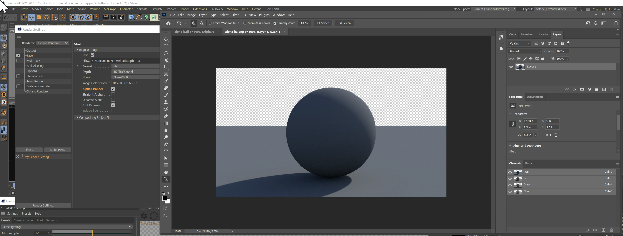

i'm trying to render out a scene element - very simple, just one kitbash building mesh that i'm trying to composite into an aerial shot. nothing fancy, just testing.
the problem is that when i click "alpha channel", my live viewer responds properly, giving me alpha, but the same exact frame rendered to .tiff includes the octane sky background.
even if i override kernel settings and specifically check 'alpha channel' in the render settings, i still get the octane sky background, no alpha.
this same behaviour happens with any object, if i just instantiate a cube and add an octane sky, i get the same result: alpha works in the preview window, but rendering to .tiff yields the sky background.

did you check in a compositing app, if the Alpha channel is present in the Tiff file? If you save in PNG 8bit or 16bit, the Alpha channel is directly applied: ciao Beppe

sigh... you know, it's rare that i post with a problem like this, and i felt like i had tried everything. so it's embarrassing to admit that sure enough, all is fine with the output .tiff files when i load them up for comping.
thanks for the sanity check. i was definitely getting thrown off by the picture viewer result.
