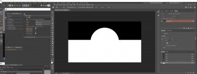

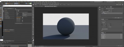

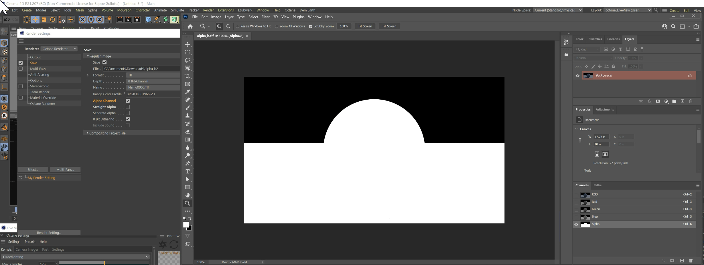

did you check in a compositing app, if the Alpha channel is present in the Tiff file?
If you save in PNG 8bit or 16bit, the Alpha channel is directly applied:
ciao Beppe

sigh... you know, it's rare that i post with a problem like this, and i felt like i had tried everything. so it's embarrassing to admit that sure enough, all is fine with the output .tiff files when i load them up for comping.
thanks for the sanity check. i was definitely getting thrown off by the picture viewer result.
