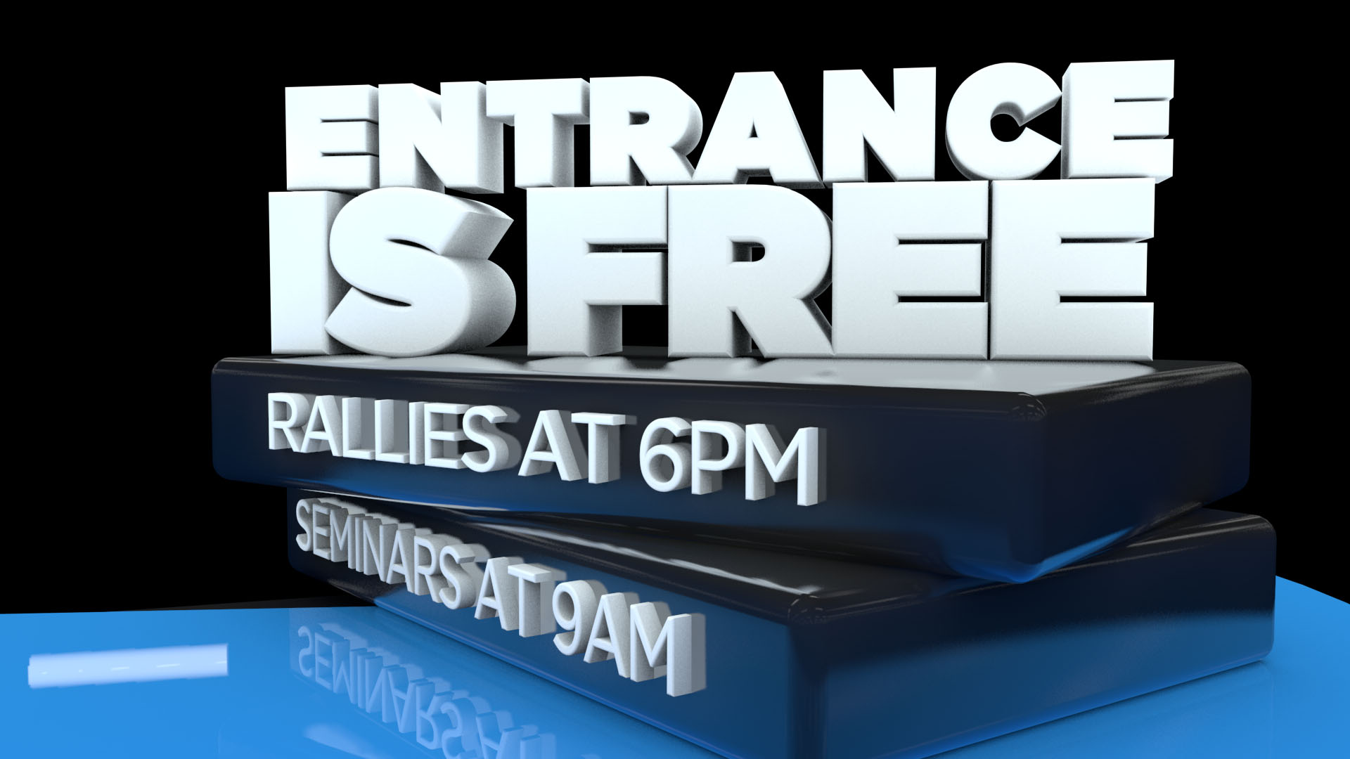

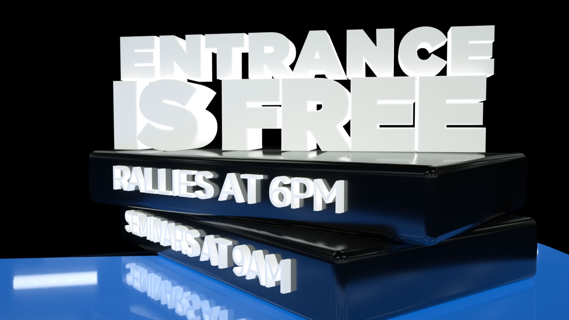

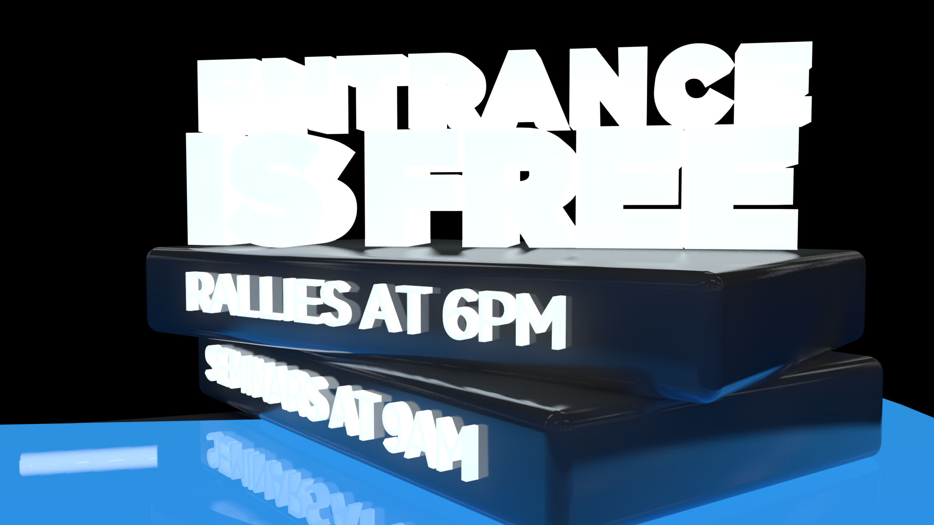

Hi i have three images here two from Cinema 4D and one from Octane render.
I am trying to recreate the darkening in between the text while still using a mesh light
Any help on how this can be done?
Octane [Mesh with light]
Cineam 4D [Mesh with light & no AO]
Cineam 4D [Mesh with light & AO]

You can render an AO pass in Octane or Cinema and comp the result with the Octane render together.

Thank you very much I should have thought of that.
I guess I was looking for a way to do everything at one go

Try using the direct lighting kernel and play with the AO distance. That should give you a similar effect.

another way would be to backe the AO of the letters in c4d and than use it as texture emission in octane :roll:
