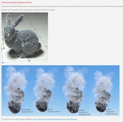

Please find the Orbx file to refer to.

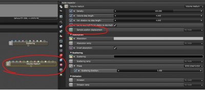

The volume displacement is done using OSL textures pinned into Sample Position Displacement on the Octane Scatter nodes.

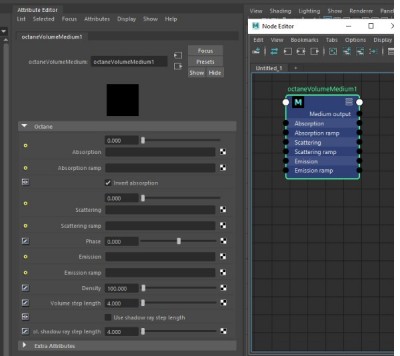

I have been investigating how to do the same thing that comes in the standalone example in maya and I don't see the way to do it.
The problem is that in maya there is no entry for "displacement position", while in standalone there is. It seems that it is an option that is not integrated in maya.

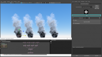

Sorry! we would implement this option in the next build.
As a workaround, we can use ORBX proxy or the Orbx material to use the "sample position displacment"!
It would allow Edit volumes via Standalone Node Editor within the OFM plugin.
Note, the Node editor dialog must be closed in order to save the changes on the .mb or .ma file.

Sure, it seems we can get the same displacement result using the ORBX proxy only.
Sorry about my previous comment on Octane VDB, we would add the "displacement position" in the next release.
