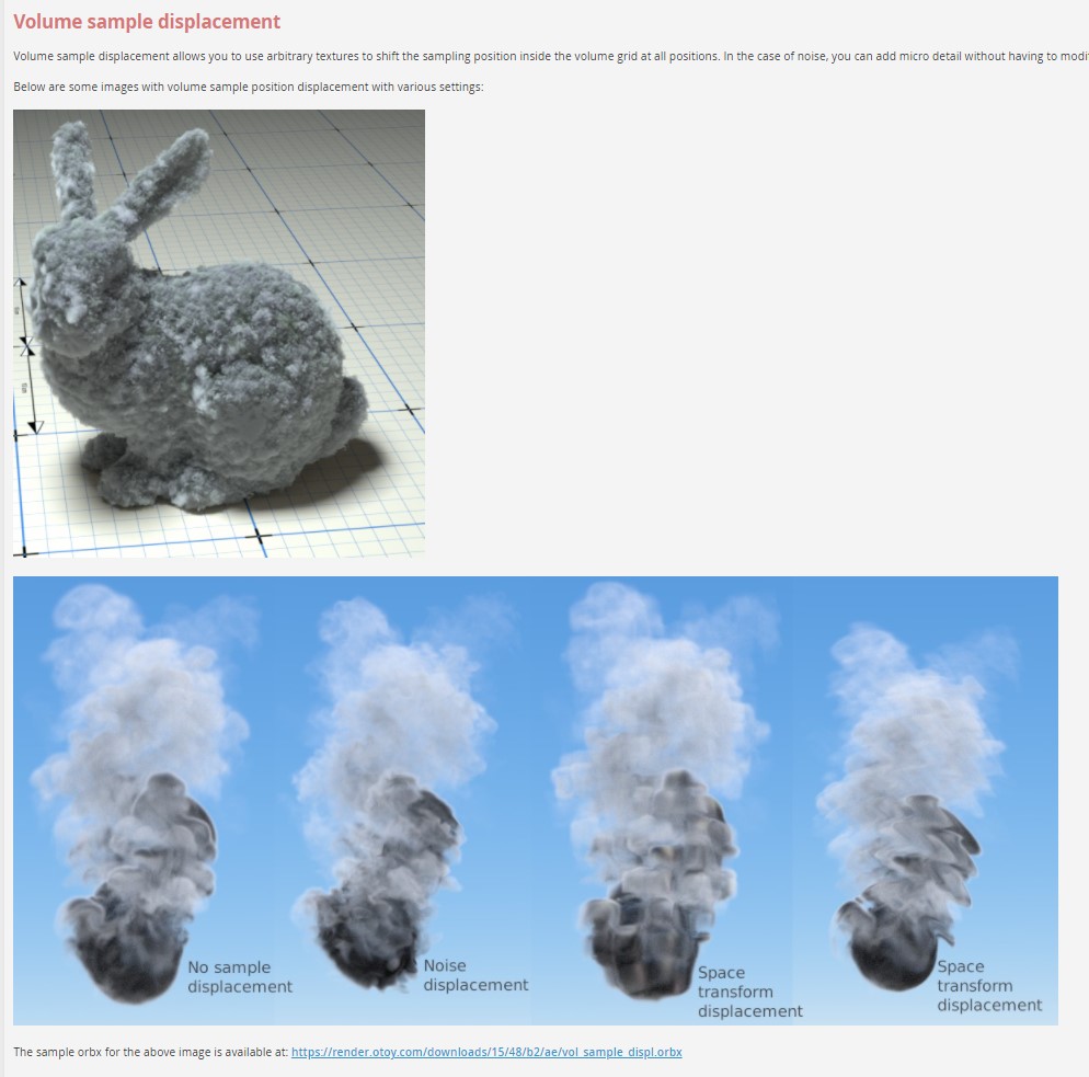

I am looking for a way to apply a displacement to a volume. I have searched in the help, in the forums and I can't find anything. It seems that there is only one way to do it with cinema 4D, but if it's a feature of octane, there should be a way to make it accessible from other software (maya, etc)...

I really don't know where to look for this information. I mean I'm just trying to apply a software feature "Volume sample displacement" either in maya or in standalone.
It's hard to understand that there is a feature that is advertised, but there is no manual, no tutorial... No answer in the forum on how to use it...
Please... Any information about this?

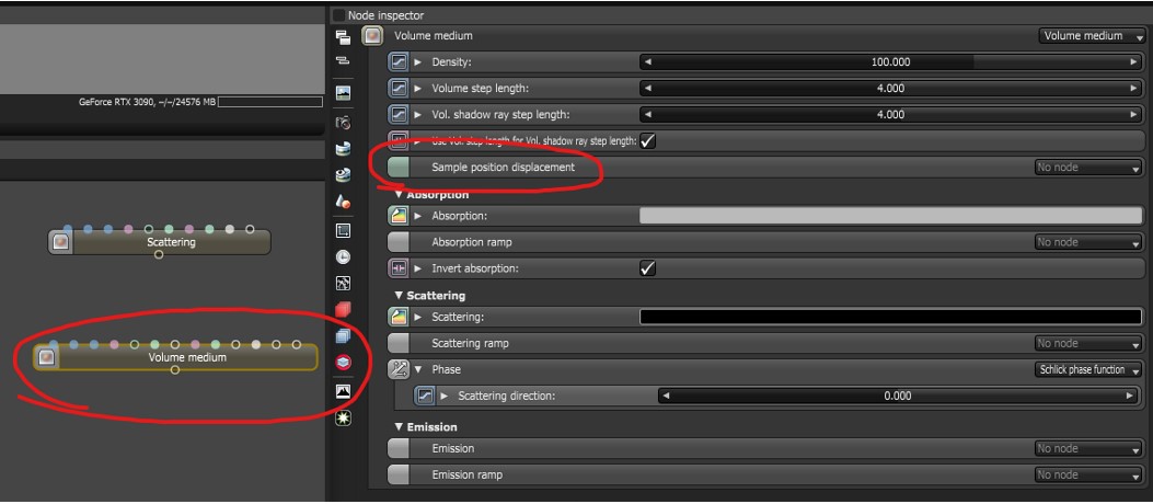

Hi Maskeline,
Sorry for the late reply and thanks for clarifying!
Please find the Orbx file to refer to.
The volume displacement is done using OSL textures pinned into Sample Position Displacement on the Octane Scatter nodes.
Hope you find it useful.

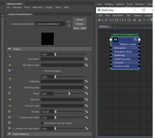

I have been investigating how to do the same thing that comes in the standalone example in maya and I don't see the way to do it.
The problem is that in maya there is no entry for "displacement position", while in standalone there is. It seems that it is an option that is not integrated in maya.
I thought it would come in the next version (in 2021) but in the current beta the option in Maya still does not exist.

Maskeline wrote:Hello.

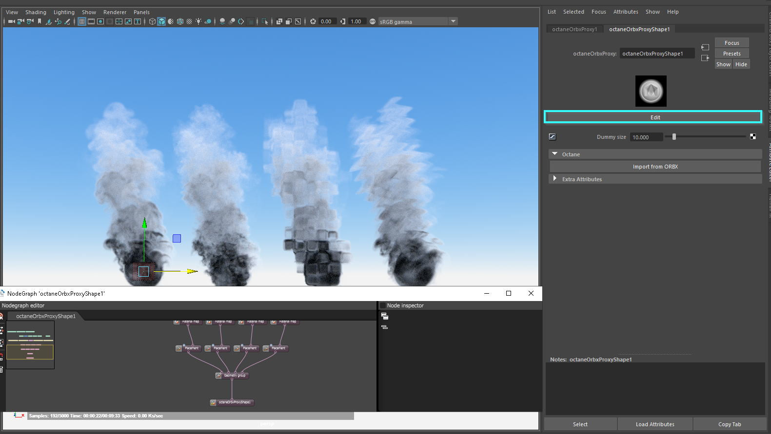

Hello Maskeline,
Thank you so much for this.
Sorry! we would implement this option in the next build.
As a workaround, we can use ORBX proxy or the Orbx material to use the "sample position displacment"!
It would allow Edit volumes via Standalone Node Editor within the OFM plugin.
Note, the Node editor dialog must be closed in order to save the changes on the .mb or .ma file.
Cheers

Hi Maskeline,
Sure, it seems we can get the same displacement result using the ORBX proxy only.
Sorry about my previous comment on Octane VDB, we would add the "displacement position" in the next release.
