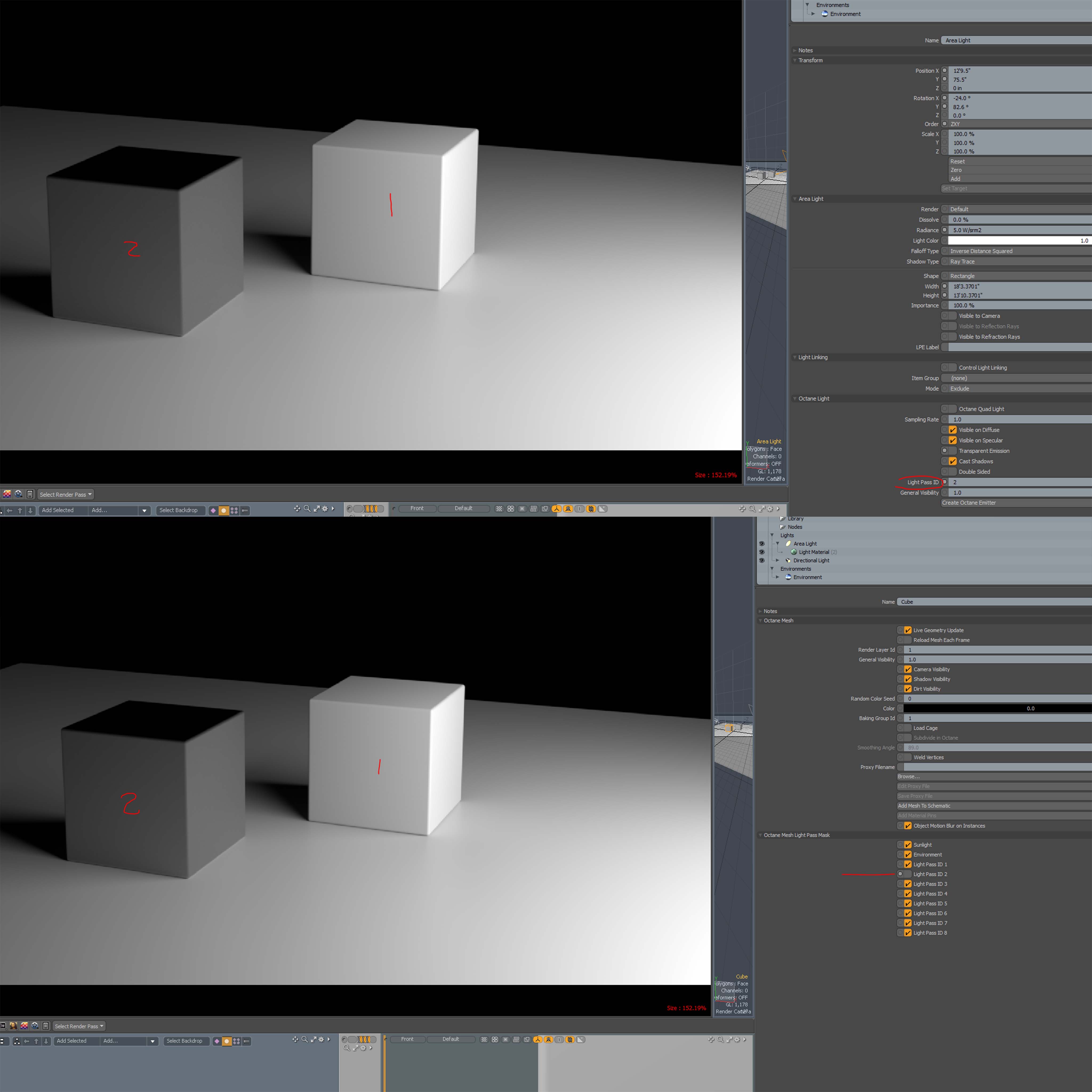

sorry - I didn't follow up after I realized the version I was using was listed as test - I am doing the exact same thing as in the previous version, but maybe its technically the wrong way - I have an area light, change it's light pass ID to 2, then select the geo I don't want the light to affect and uncheck the light pass ID mask 2. it works exactly as I want in the "stable" version - I also noticed the light ID's menu in the kernel settings disappears after a min.

this image shows how I use light pass ID in the previous version and it works great -I just tried Modo15_2020_2_3_170_studio and it still does not work how the previous version did - am I doing something wrong? I find this an incredibly useful feature, I would love to have it working in the new version -

I just tried it using the Modo15 - OctaneRender for Modo 2020.2.3.171 build in the first post ( viewtopic.php?f=34&t=73539 ) and its working the same as your screenshot.

yes! just tried 2020.2.3.171 and its working! thanks!
