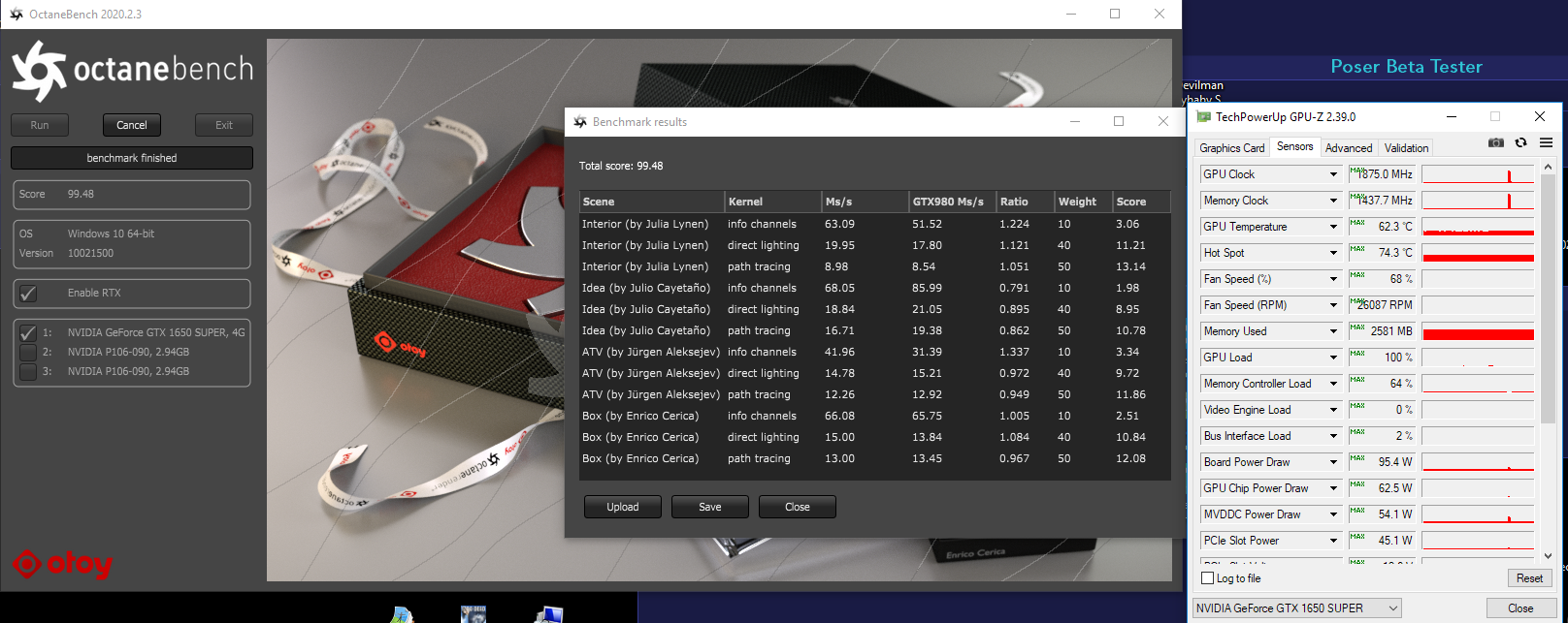

Here are screenshots.
I have 2 P106-100 and 1 1650 Super. 1 of the P106-100 is on a x1 Pcie Riser.

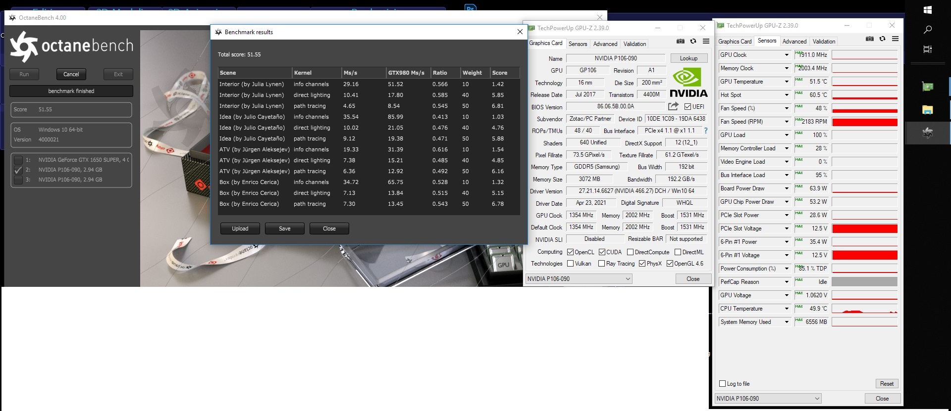

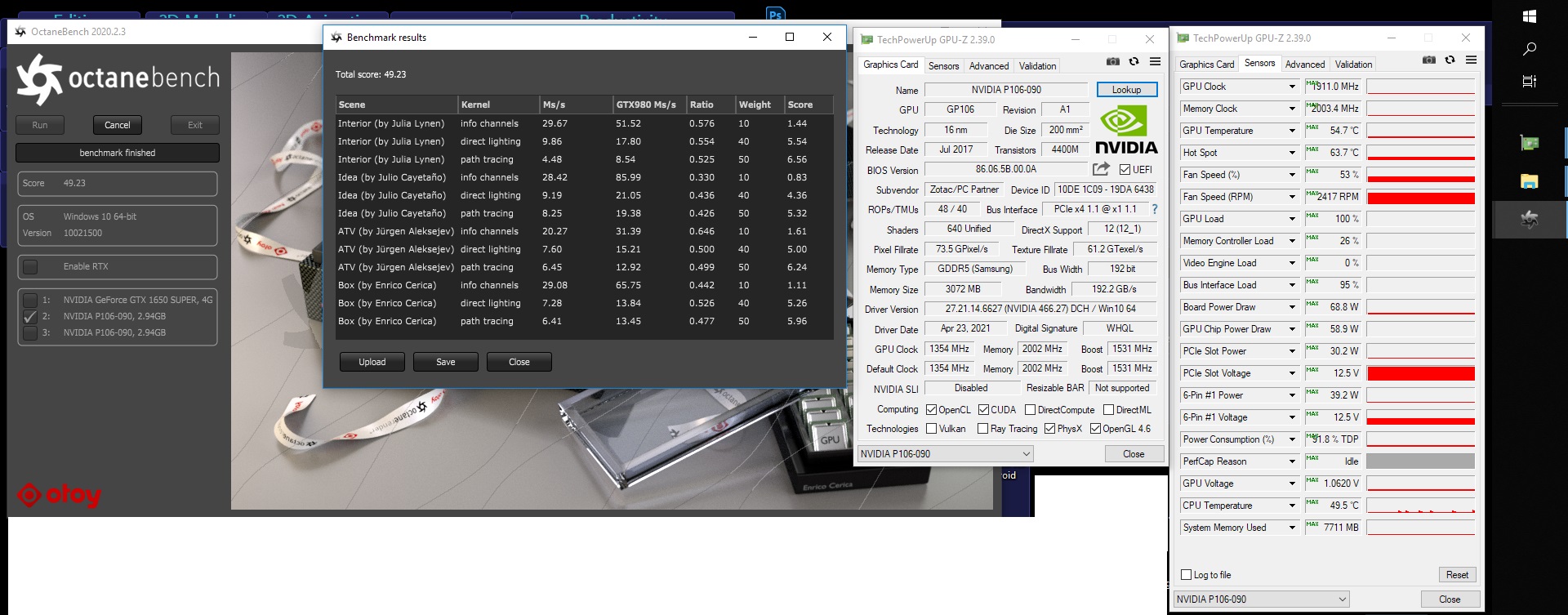

everything seems ok, but GPU-Z screenshots are not complete.
Temperature seems ok, but Tdr Power Consumption parameter is not visible.
Please also share a screenshot form GPU-Z Graphics Card tab, thanks.

sorry. I didn't notice that.

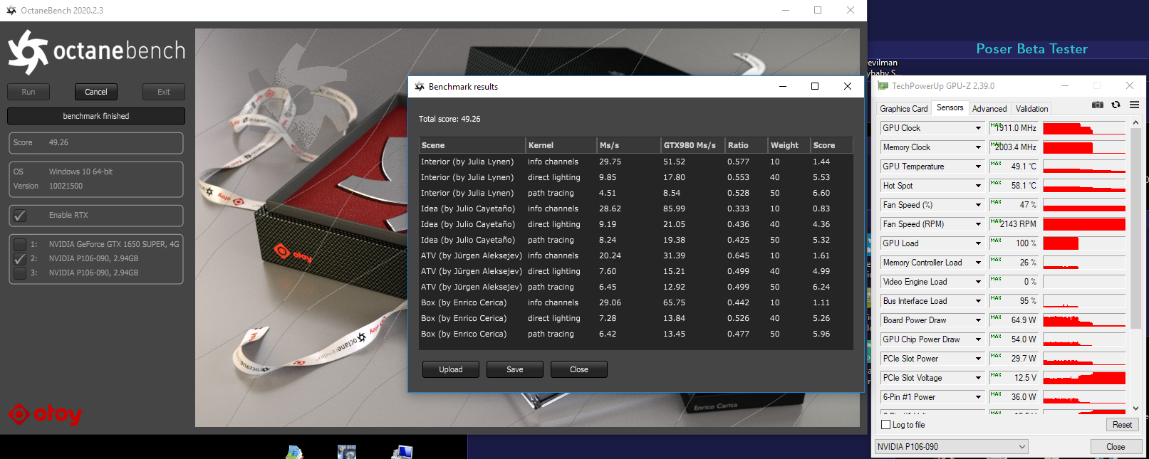

Ok, thanks for the collaboration.
I think that everything is ok, to be sure, please run OctaneBench 4.00c, and share the result:
https://render.otoy.com/downloads/a/787 ... 0c_win.zip
Unfortunately we don’t have other results in OctaneBench 2020.2.3 for Nvidia P106-090 :roll:
The only similar result is from a different GPU, Nvidia P106-100 in OctaneBench v4.00c:
https://render.otoy.com/octanebench/res ... owRTXOff=0
But Nvidia P106-100 is this:
https://www.techpowerup.com/gpu-specs/p106-100.c2980
While Nvidia P106-090 is this:
https://www.techpowerup.com/gpu-specs/z ... -090.b4832
ciao Beppe

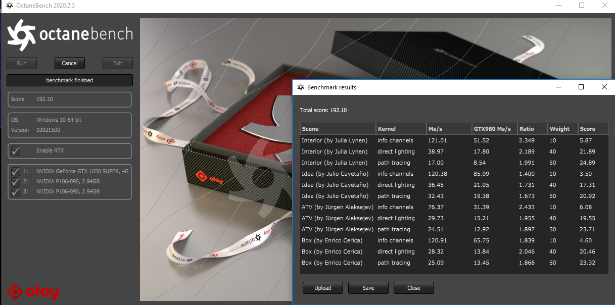

Okay, So I was getting confused by the model of GPU.
Here's the screenshot of using Version 4 Benchtest.

Posts: 10643
Yes, as you can see the result from v4.00c is similar.
Please run again the test with 2020.2.3 OctaneBench, and press the Upload button at the end, it will be useful for other users in future.
