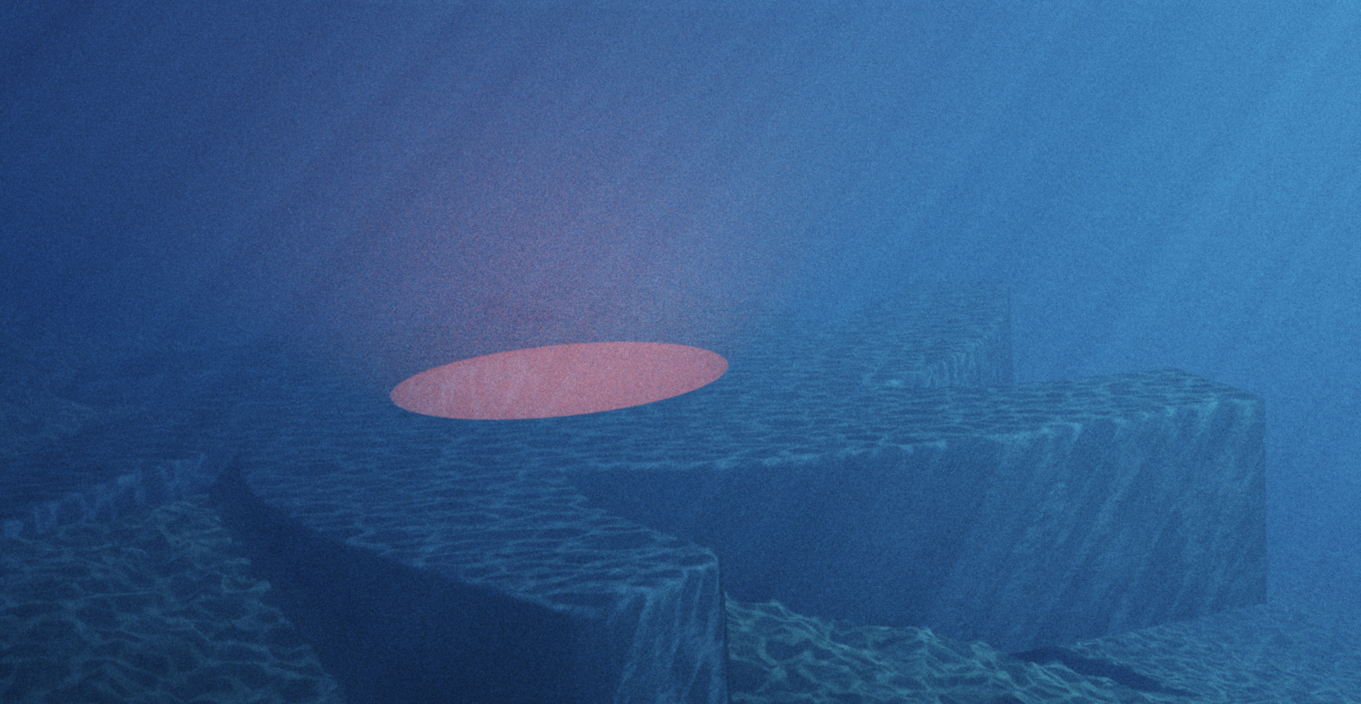

Here is an example frame made with this technique:
ciao Beppe
