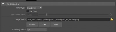

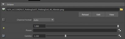

after further investigation it looks that :
This is working properly with Maya standard image loader and Arnold : Note that it looks that windows doesn't allow envar concatenation.
Env var access does work, you just need to modify it to update texture location, but this is kinda redundant with the Maya File Path Editor wich already work with arnold.
- >BUT you can't use env var with octane image file loader in hypershade : this will not work in octane. It looks that the loader is not able to understand env var.
-> You also can' t use env var at all in standalone or in maya orbx material the browser does understand %MY_VAR1%\my_path\, but it doesn't store it in the file name, it just replace everything by the full path.
-> Same issue with Maya File Path Editor which doesn't look to work with octane orbx nodes, it does look to works with octane file loader.
it looks that you can only do that manually if you use the orbx material.

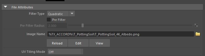

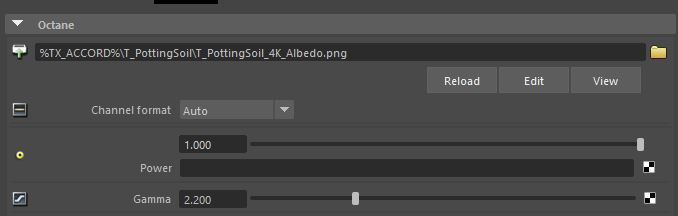

Yes the path texture editor work with octane image loader but it doesn't work when you use the orbx material and the standalone UI loaders.
BUT i have encounter weird behavior and bug with the texture path editor recently. like many features Autodesk do, they are only working half.
if you don't have a very clean naming conventions the editor mix everything and plug the wrong maps. to be sure you don't have bad suprise it's better to do per material texture folder, and replace the path per material, you are 100% sure that maya will not do some magic stupidity in your back.
