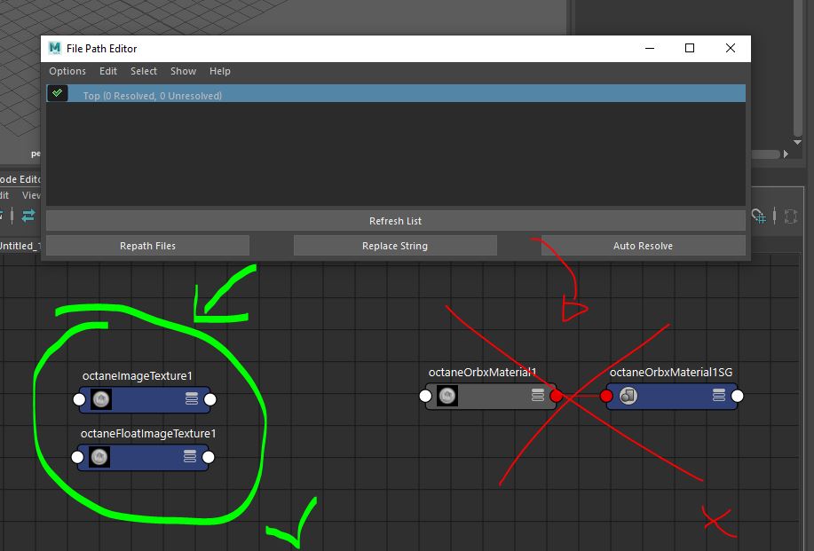

-> Same issue with Maya File Path Editor which doesn't look to work with octane orbx nodes, it does look to works with octane file loader.

Yes the path texture editor work with octane image loader but it doesn't work when you use the orbx material and the standalone UI loaders.
BUT i have encounter weird behavior and bug with the texture path editor recently. like many features Autodesk do, they are only working half.
if you don't have a very clean naming conventions the editor mix everything and plug the wrong maps. to be sure you don't have bad suprise it's better to do per material texture folder, and replace the path per material, you are 100% sure that maya will not do some magic stupidity in your back.
