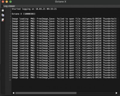

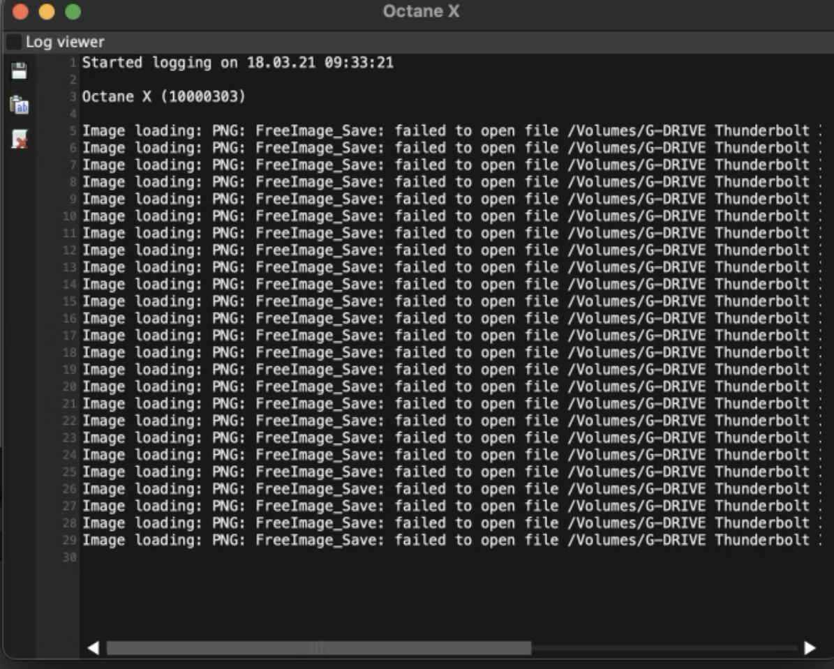

However, when I check my finder, there's nothing there. Digging into the logs, and I find this:
Image loading: PNG: FreeImage_Save: failed to open file /Users/abeyang/p0001.png

Yes confirmed, both Daylight, and Turntable animation scripts are not saving the result to disk, in the latest version, it is not an issue of M1 chip only:
I’m forwarding it to the devs, it will be fixed for the next version.

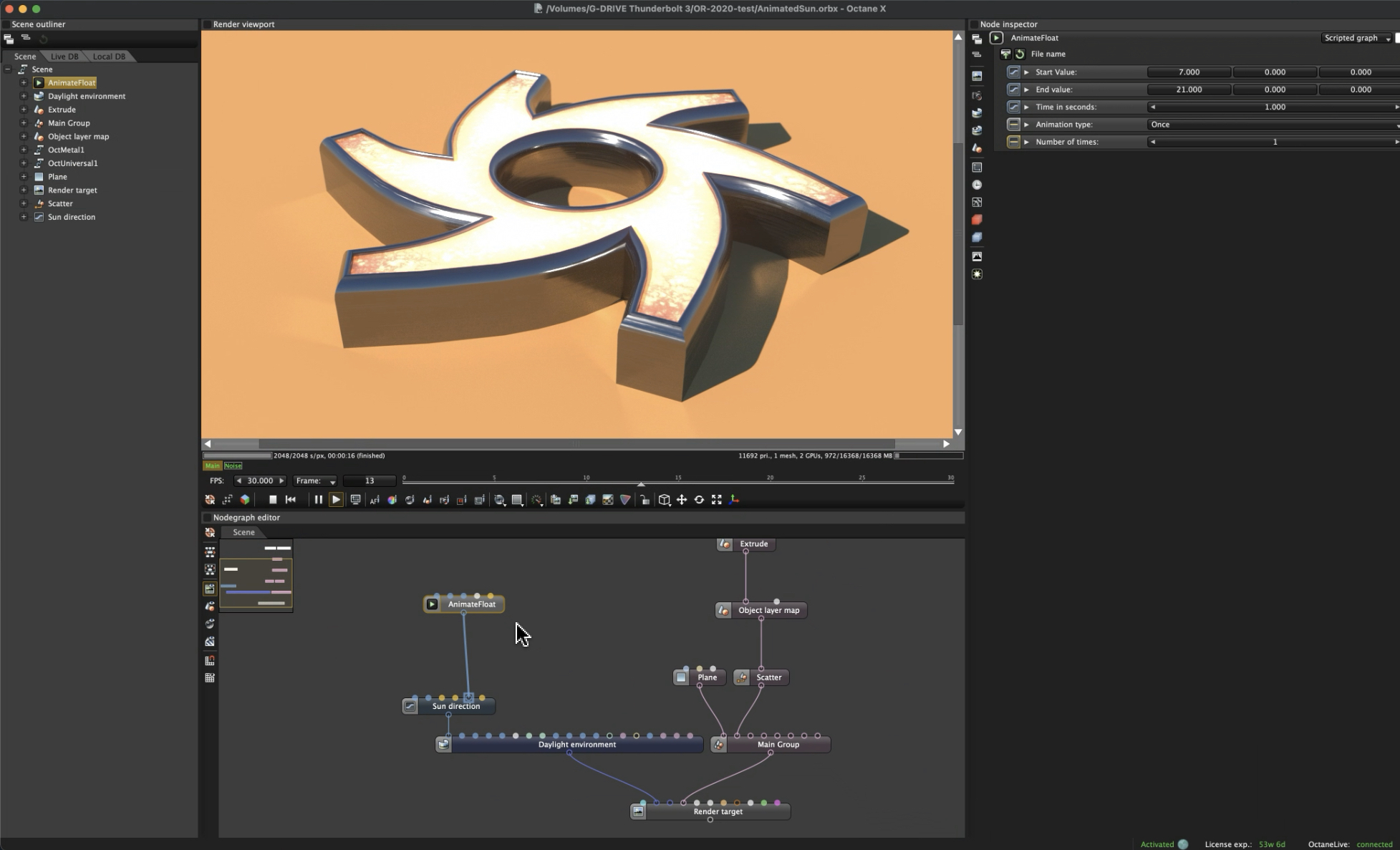

please try with this scene:
AnimatedSun.orbx
(1.82 MiB) Downloaded 161 times
There is a Lua ScriptedGraph node to animate the Local Time pin of the Sun Direction node:
