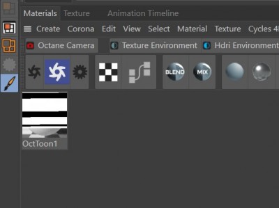

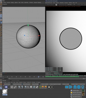

If I Create a toon shader it looks messed up in the preview then Octane crash in live viewer.
I've used toon shader for a while now as a way of rendering solid colours, now in this version, it doesn't seem to work and just crashes once I start the live viewer.
Works with other materials, just seems to be a bug with the toon shader!

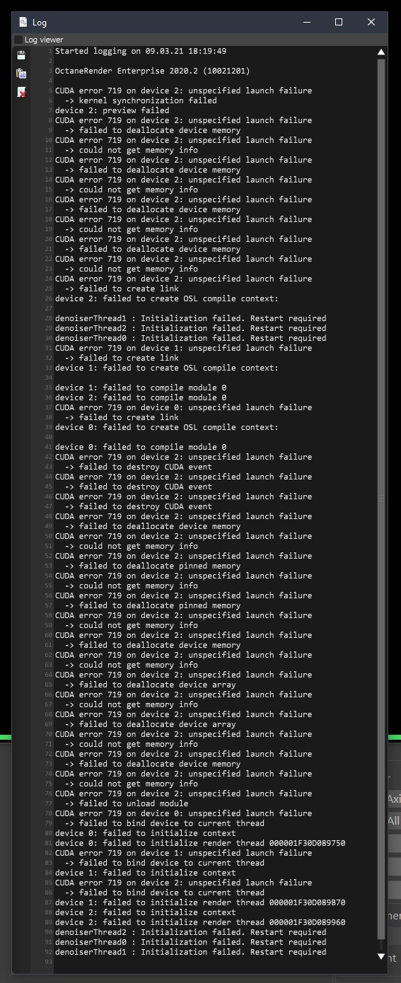

- octane 2020.2 210309 182940.txt
- (3.99 KiB) Downloaded 161 times

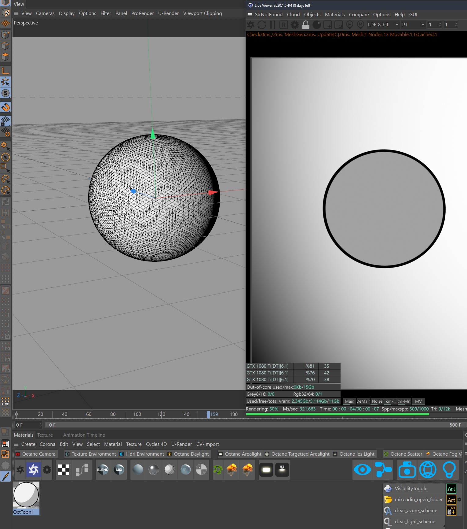

Just rolled back to 2020.1.5-R4 and TOON SHADER is working absolutely fine so pretty confident this is a bug, and maybe nobody else uses the toon shader like I do!
Will stay on this version for now.
Pretty gutted cause I want to work with the new colour profile stuff!!!
Windows 11 Pro | ASUS Pro WSX80E | AMD Threadripper Pro 5975WX 32-Core | 256GB Micron 8x32GB 3200MHz ECC | 2x PNY RTX6000 ADA
It's fixed for 2020.2.1 builds and was a known and reported issue. Thanks!
