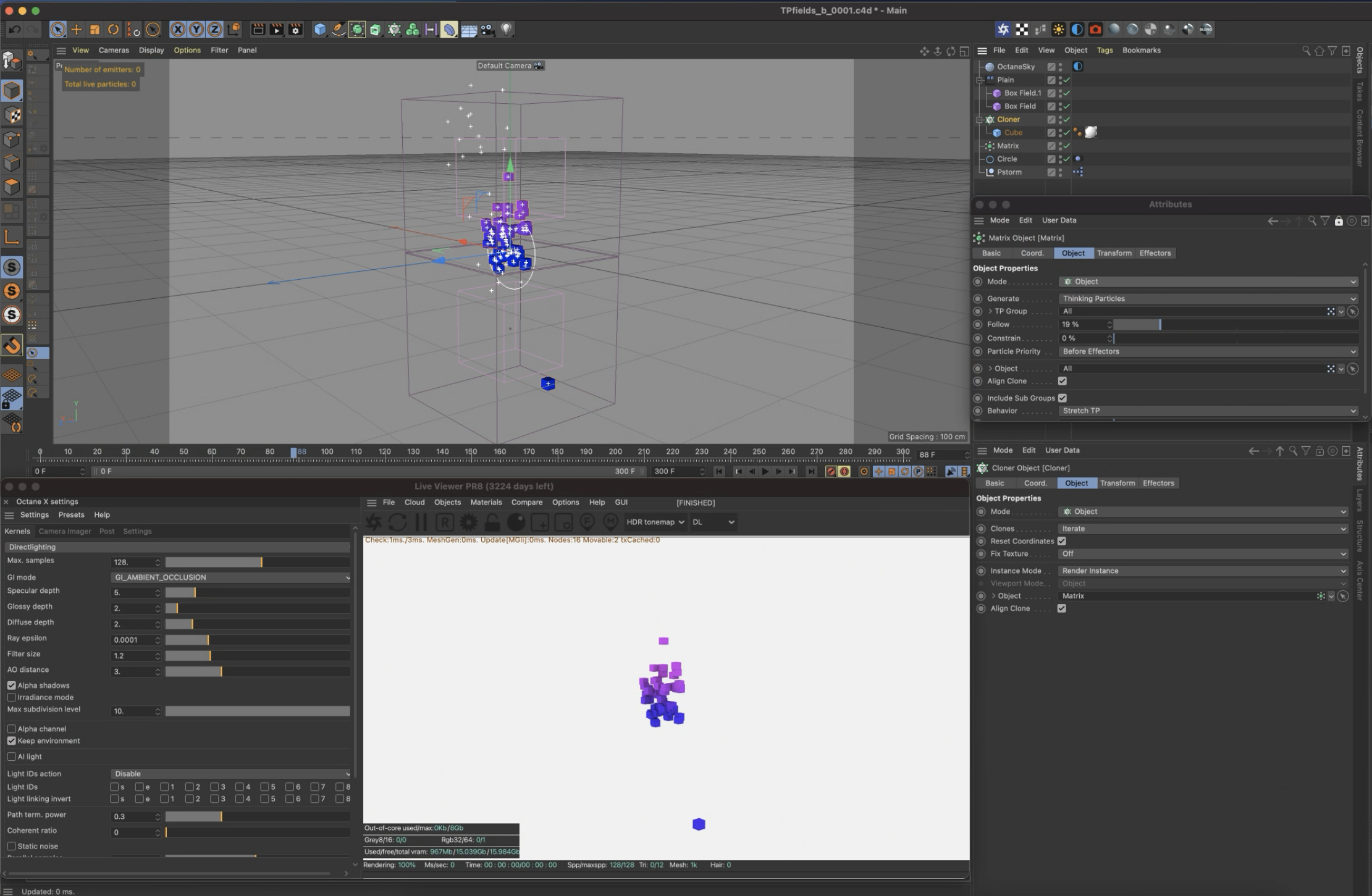

you need to assign Thinking Particles to a Matrix object, and the Matrix object to a MoGraph Cloner:
