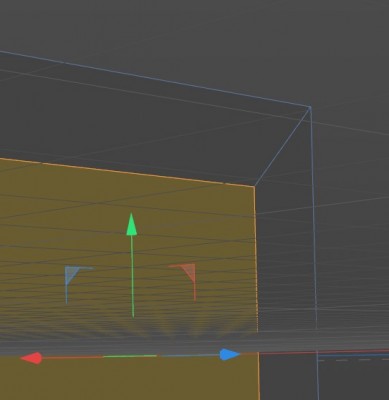

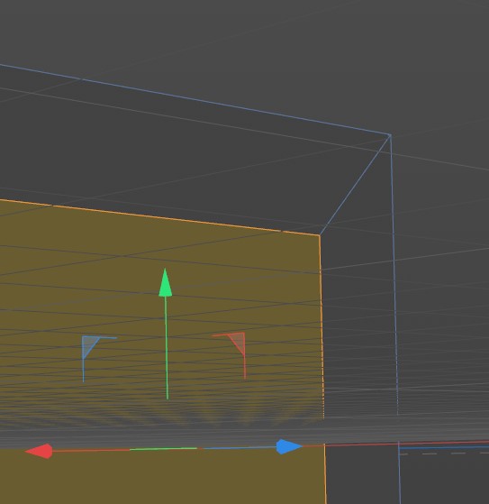

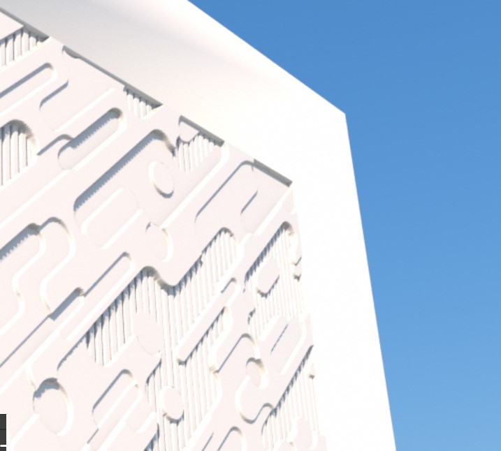

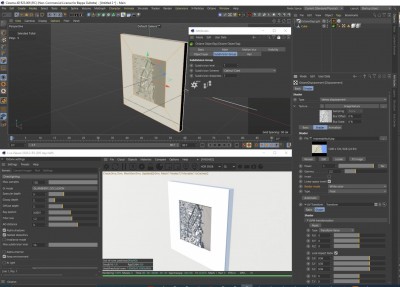

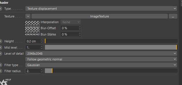

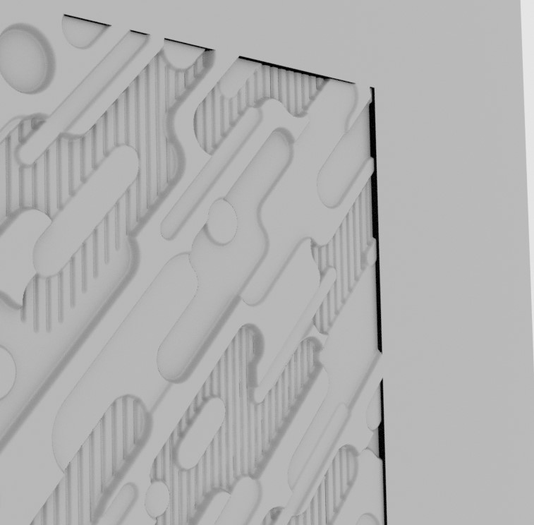

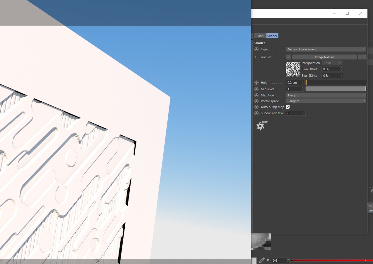

i have a problem with a repetitive pattern displacement. The border is black.
Any help how to solve this?
Thanks,
Stefan

seems like the same result with the borders.

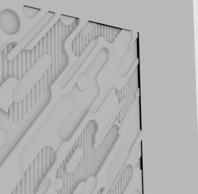

i solved it for now by extruding the polygon inward. it´s not very nice, but you can´t see the black border anymore.

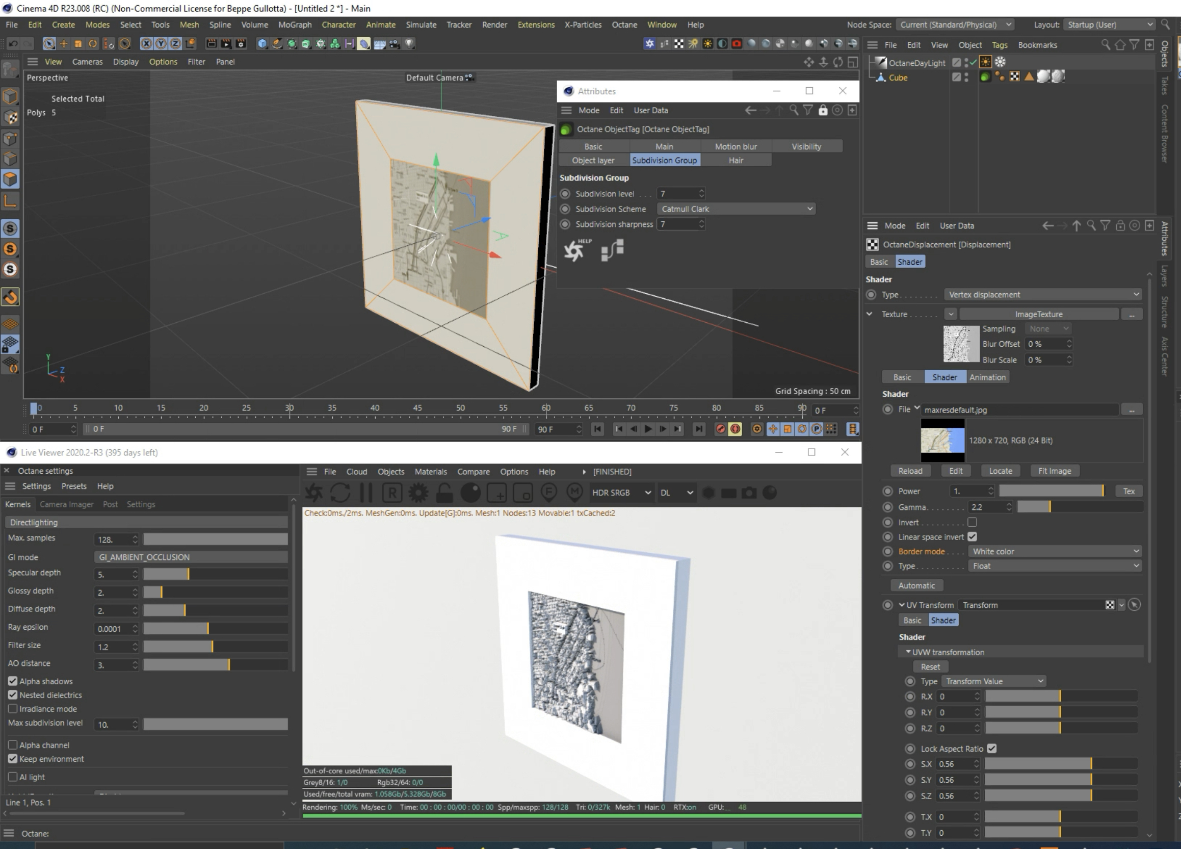

Posts: 10643
try these steps:
- add to the polygon selection also the four polygons of the border.
- add an Octane Object tag with high subdivision on both level and sharpness.
- use the Displacement in Vertex mode, with 0 subdivisions.
- set the Border Mode in the ImageTexture node used for Displacement to White.
- use the UV Transform to reduce the scale until it matches the borders.
ciao Beppe
3D3R
Posts: 16
Joined: Wed Jan 30, 2019 6:44 pm
ok, thanks!
