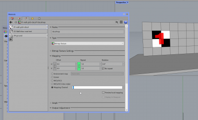

Here is something I wanted to show you for a long time:
walth-23-02-2021-decalbug.mp4
(15.4 MiB) Downloaded 3472 times
as it seems octane does not respect mapping channels other than 1...
here is the scene and the mappings:
UV-Decal-Test.zip
(217.84 KiB) Downloaded 296 times
If you have any questions about this I would be happy to help.

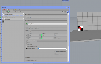

Firstly, the Rhino renderer is not rendering this scene as you are wanting, so I think something is not right with it.
I am not quite sure what you mean...
If I set up a Rhino material, I can apply the different mapping channels to the texture and it will display / render accordingly:
...Or did I misunderstand you?
Your scene as downloaded did not render that way, so I thought something wrong :-) Regardless, the other comments still apply.
