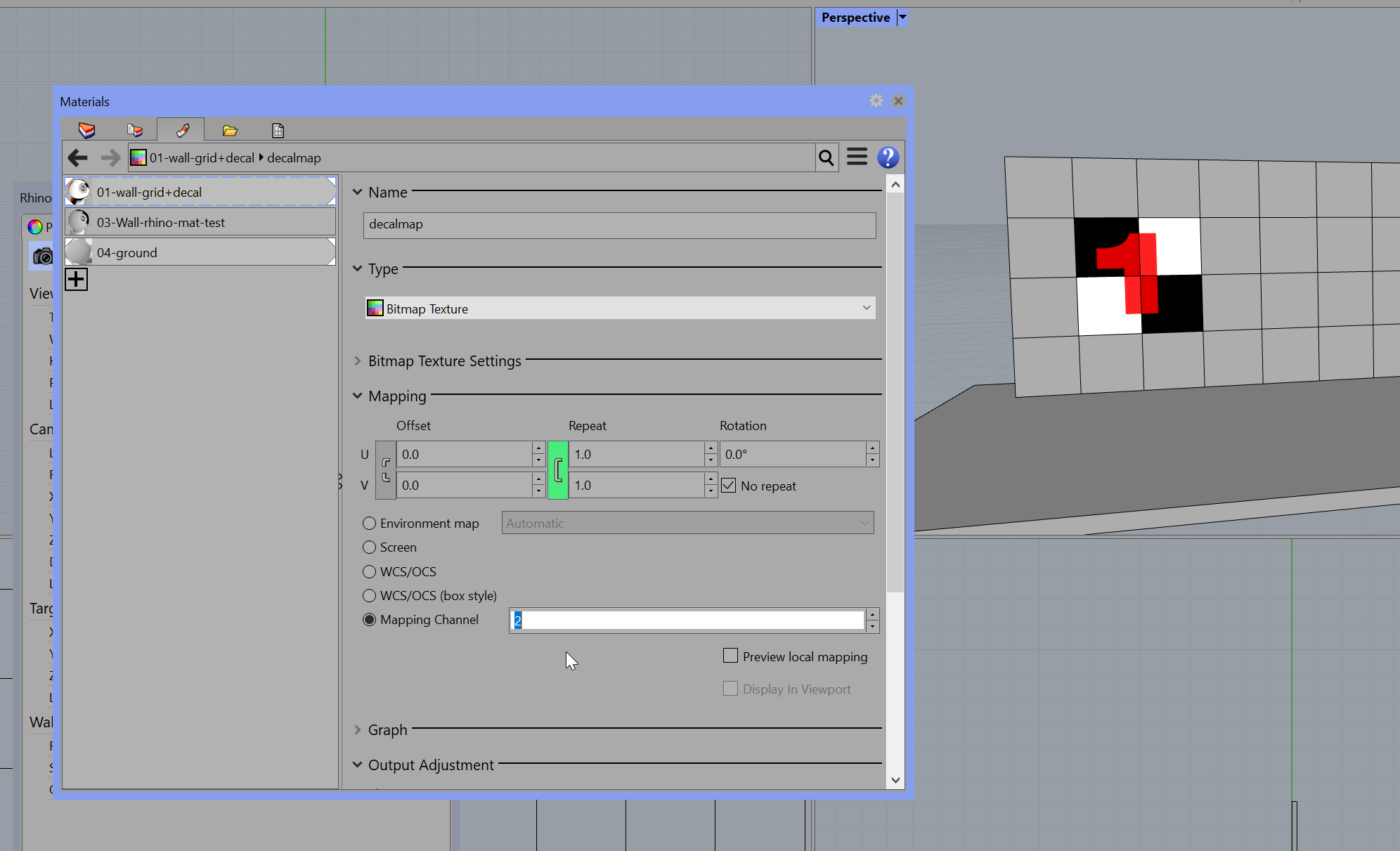

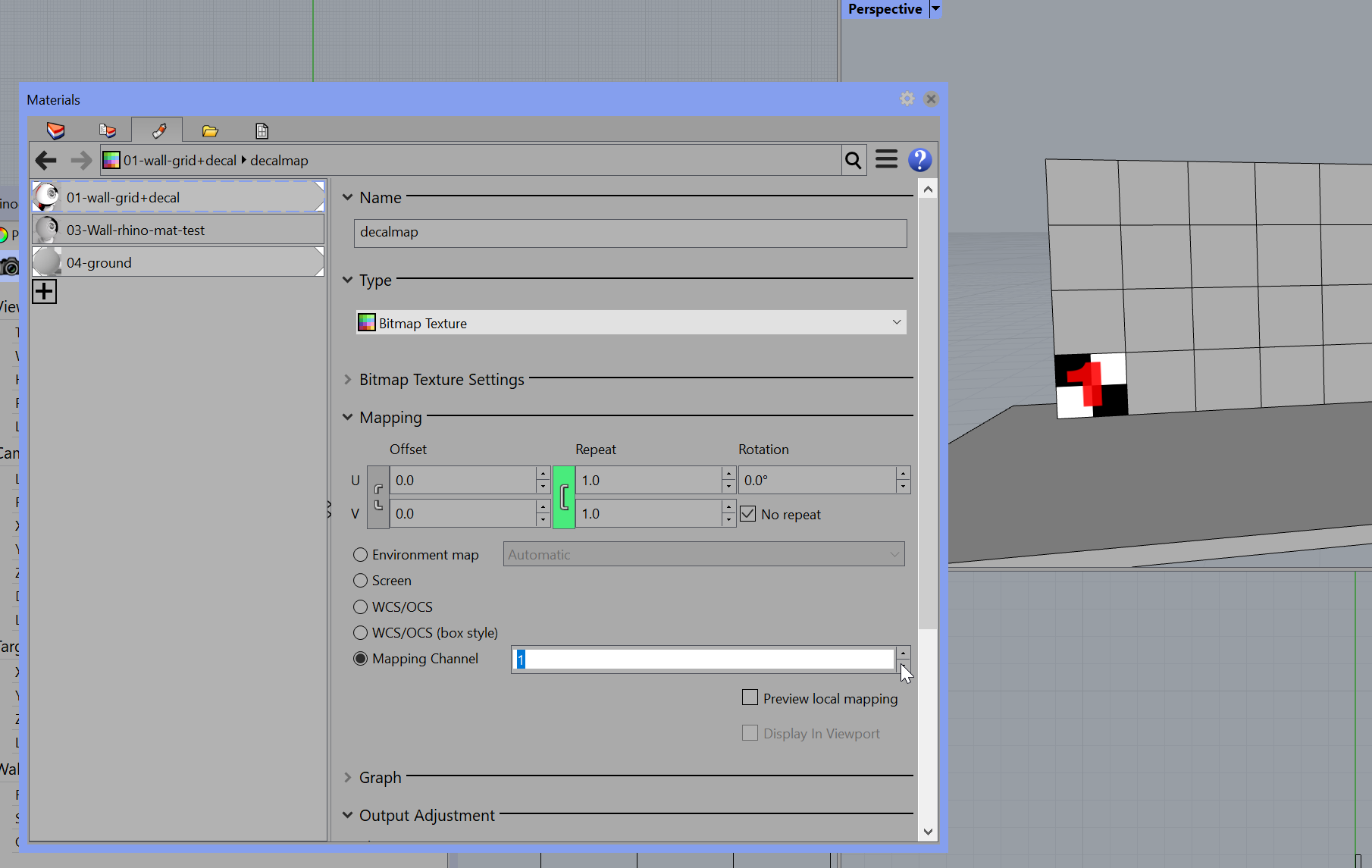

If I set up a Rhino material, I can apply the different mapping channels to the texture and it will display / render accordingly:
...Or did I misunderstand you?
I am not quite sure what you mean...Firstly, the Rhino renderer is not rendering this scene as you are wanting, so I think something is not right with it.
