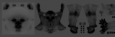

Screenshot below shows the G8 UVs in Blender: 0 to 1 is Face, 1 to 2 is Torso, 2 to 3 is Legs, 3 to 4 is arms and even further right are the eyes and such. So to get your gun shot wound to show up on the torso add 1.0 to whatever the 'Translation X' value of your 2D Transform node is (i.e. if it's currently 0.35 make it 1.35). Then you should see it on the character's chest.

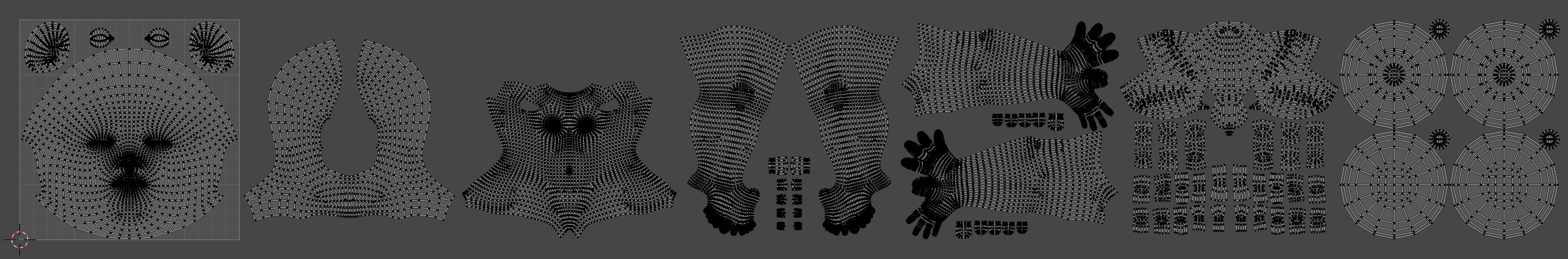

Good question - I hadn't looked at the Genesis 8.1 UDIM layout yet. Looks like the new Head UVs were inserted second, after the Face UVs. So everything but the Face UVs are shifted 1 to the right compared to Genesis 8 base.
From left to right it is Face, Head, Body, Legs, Arms, Mouth/Teeth and Eyes.
