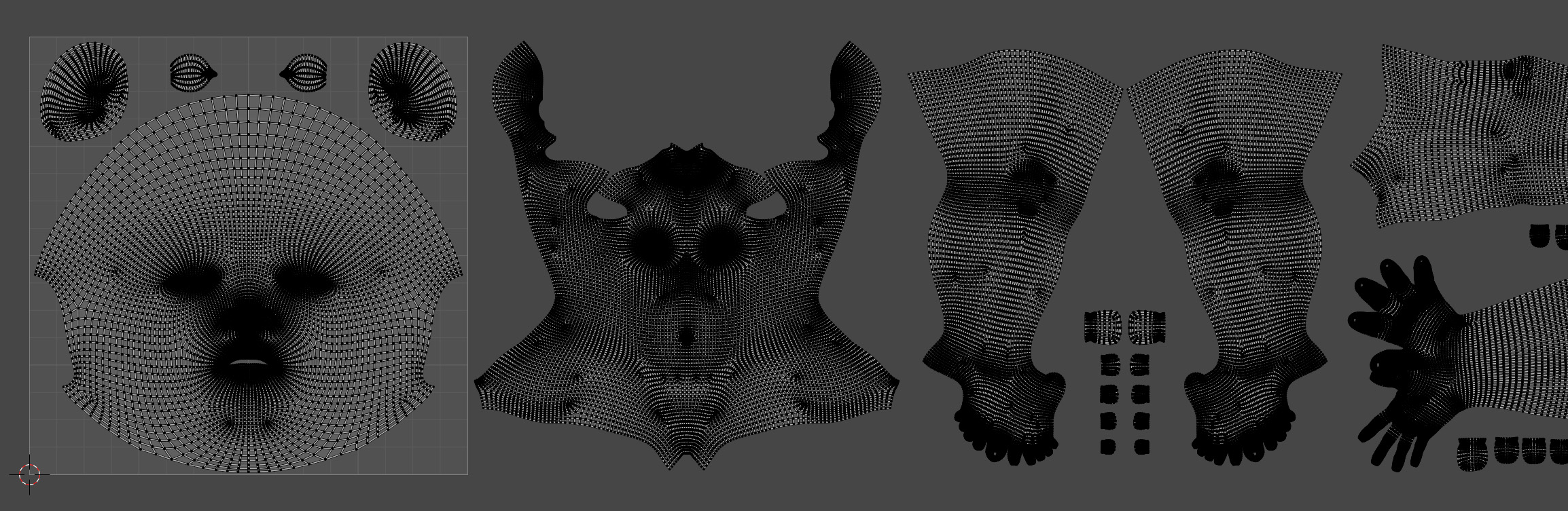

The gun shot wound is not showing up on your character because the Genesis figures use UDIM for their UV layout. When border mode for the texture is set to Wrap Around this doesn't really matter, but I believe you have it set to Black Color for the gun shot wound mask since you scaled it and don't want it repeating. This is fine, but you need to translate it to the right, since the torso UVs are outside of the 0 to 1 UV coordinate space.
Screenshot below shows the G8 UVs in Blender: 0 to 1 is Face, 1 to 2 is Torso, 2 to 3 is Legs, 3 to 4 is arms and even further right are the eyes and such. So to get your gun shot wound to show up on the torso add 1.0 to whatever the 'Translation X' value of your 2D Transform node is (i.e. if it's currently 0.35 make it 1.35). Then you should see it on the character's chest.
G8F UVs

Good question - I hadn't looked at the Genesis 8.1 UDIM layout yet. Looks like the new Head UVs were inserted second, after the Face UVs. So everything but the Face UVs are shifted 1 to the right compared to Genesis 8 base.
From left to right it is Face, Head, Body, Legs, Arms, Mouth/Teeth and Eyes.
