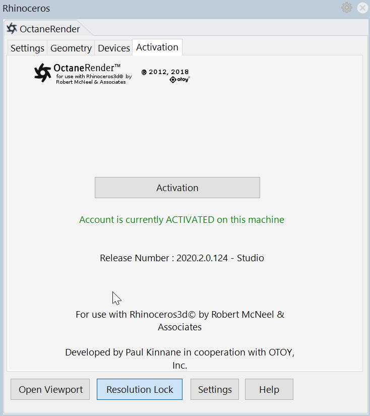

Hi Andreas, what version of the plugin are you using please?
Paul
v-cube
Posts: 491
Joined: Fri Jul 22, 2011 11:02 am
Location: Aachen, Germany
latest test build
