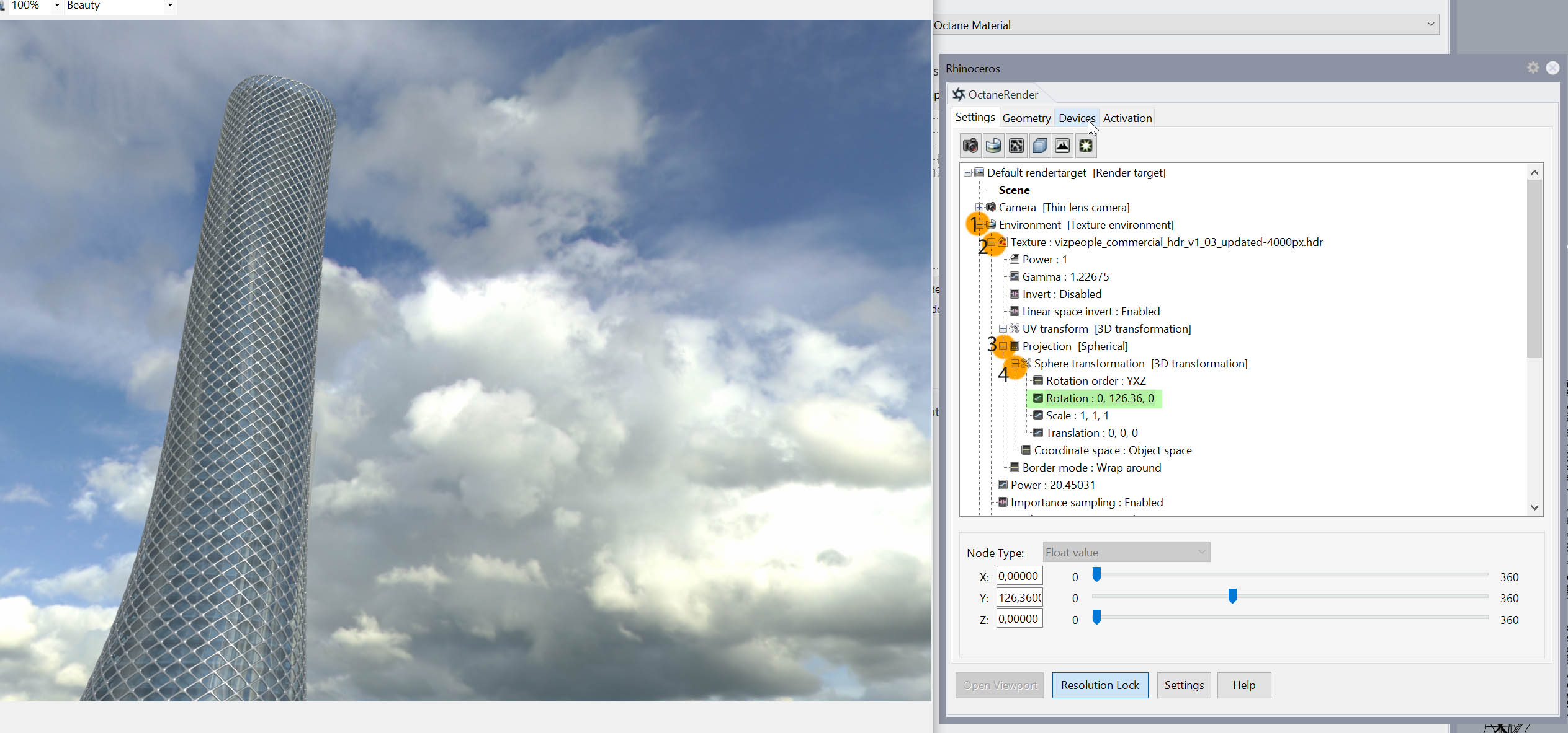

here is something else which keeps bugging me and I wonder if there might be a solution for this ;-)
look at this pic:
The node for rotating a HDR Image is, as you can imagine, something we use very frequently on a daily basis.Unfortunately it is deeply buried in the node hierarchy, so getting there is rather cumbersome.
In addition to the effort it takes to actually get there, even after opening 4! sub categories and having adjusted your rotation value, your vertical UI space is cramped up with stuff you do not need, so you have to close them again...
Is there maybe a possibility to create some (user defined? ) shortcuts to certain nodes?
IMHO that would considerably speed up the workflow for all users since due to the vast (and very appreciated !) possibilities of octane the UI has become cumbersome to manage.
I a perfect world we would be able to outsource some nodes into another tab maybe (I am really daydreaming here...) it might even be possible to have sliders which would be dockable into the Rhino toolbars? That would be so awesome ! Quickly adjust lightning... rotation at your fingertips... just one click away...
Any chance??

I completely agree that this would be a great feature, although not something I could get to in the near term with all the Octane 2020.2 and 2021 work.
Have you looked at using the OctaneChangePinValue command? You could probably create a floating panel with a slider to call this command.
https://docs.otoy.com/RhinoH/RhinoPlugi ... mmands.htm
Paul

I would prefer to build hooks into the plugin so that you can build your own UI to do the specific things that you need. For example, it took 10 mins to put together a scripts to spin the HDR Image via Rhino->Tools->PhythonScript
Code: Select all
# Imports
import Rhino
import scriptcontext
import System
import Rhino.UI
import Eto.Drawing as drawing
import Eto.Forms as forms
# SetTextureEnvironmentRotationDialog class
class SetTextureEnvironmentRotationDialog(forms.Dialog[bool]):
    # Dialog box Class initializer
    def __init__(self):
        # Initialize dialog box
        self.Title = 'Set Texture Environment Rotation'
        self.Padding = drawing.Padding(10)
        self.Resizable = False
        # Create controls for the dialog
        self.m_label = forms.Label(Text = 'Enter the Rotation:')
        self.m_slider = forms.Slider()
        self.m_slider.MinValue = 0
        self.m_slider.MaxValue = 360
        self.m_slider.ValueChanged += self.OnValueChanged
        # Create the default button
        self.DefaultButton = forms.Button(Text = 'OK')
        self.DefaultButton.Click += self.OnOKButtonClick
        # Create a table layout and add all the controls
        layout = forms.DynamicLayout()
        layout.Spacing = drawing.Size(5, 5)
        layout.AddRow(None) # spacer
        layout.AddRow(self.m_label, self.m_slider)
        layout.AddRow(self.DefaultButton, self.AbortButton)
        # Set the dialog content
        self.Content = layout
    def OnValueChanged(self, send, e):
        Rhino.RhinoApp.RunScript("OctaneChangePinValue environment:texture:projection:transform:rotation " + self.GetText(), True)
    # Get the value of the textbox
    def GetText(self):
        return str(self.m_slider.Value)
    # OK button click handler
    def OnOKButtonClick(self, sender, e):
        self.Close(True)
    ## End of Dialog Class ##
# The script that will be using the dialog.
def SetTextureEnvironmentRotation():
    dialog = SetTextureEnvironmentRotationDialog();
    rc = dialog.ShowModal(Rhino.UI.RhinoEtoApp.MainWindow)
# Check to see if this file is being executed as the "main" python
# script instead of being used as a module by some other python script
# This allows us to use the module which ever way we want.
if __name__ == "__main__":
It is pretty clunky, but you get the idea.

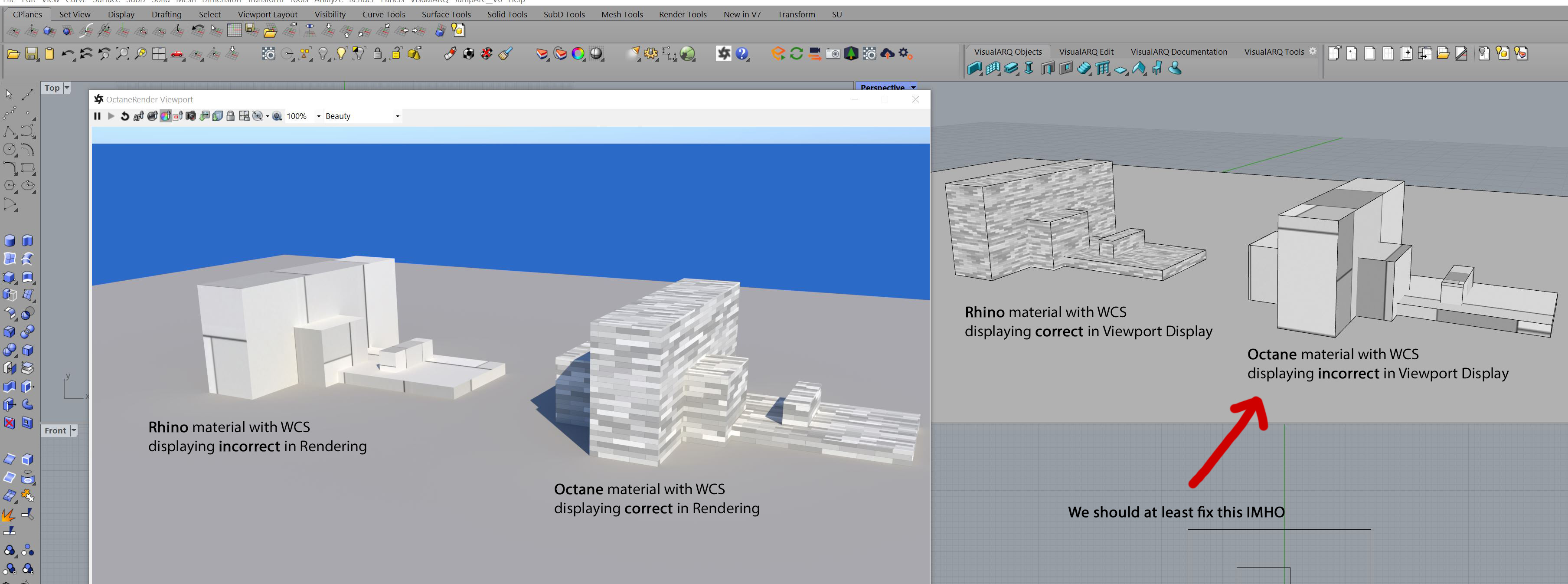

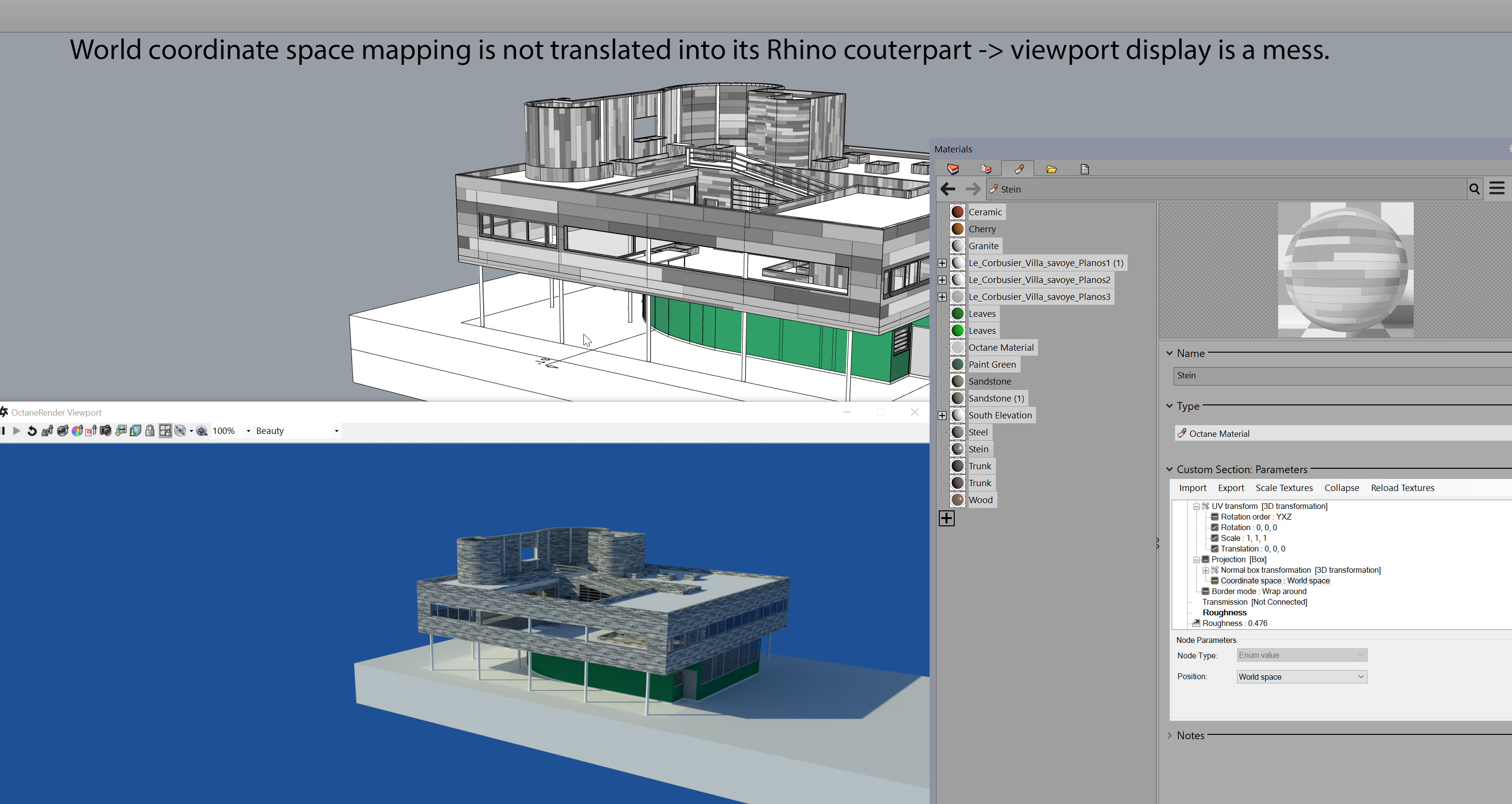

... this would be another old problem... Since World mapping space is also possible in vanilla Rhino this should work I guess...
This one would tremendously help us, since we would not have to apply individual UVW mappings to all new created objects, which is really a PITA (sorry for the bad language ...)
Andy
Architectural Rendering Services
1 x 4090 GTX, 1 x 3090 GTX
http://www.v-cube.de
face_off
Posts: 15799
Location: Adelaide, Australia
Can you send me a scene which demonstrates this problem please?
