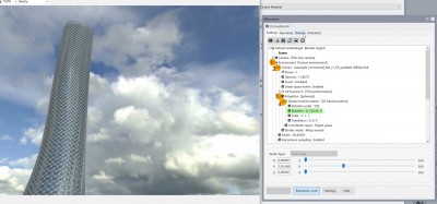

look at this pic:
The node for rotating a HDR Image is, as you can imagine, something we use very frequently on a daily basis.Unfortunately it is deeply buried in the node hierarchy, so getting there is rather cumbersome.
In addition to the effort it takes to actually get there, even after opening 4! sub categories and having adjusted your rotation value, your vertical UI space is cramped up with stuff you do not need, so you have to close them again...
Is there maybe a possibility to create some (user defined? ) shortcuts to certain nodes?
IMHO that would considerably speed up the workflow for all users since due to the vast (and very appreciated !) possibilities of octane the UI has become cumbersome to manage.
I a perfect world we would be able to outsource some nodes into another tab maybe (I am really daydreaming here...) it might even be possible to have sliders which would be dockable into the Rhino toolbars? That would be so awesome ! Quickly adjust lightning... rotation at your fingertips... just one click away...
Any chance??

I completely agree that this would be a great feature, although not something I could get to in the near term with all the Octane 2020.2 and 2021 work.
Have you looked at using the OctaneChangePinValue command? You could probably create a floating panel with a slider to call this command.
https://docs.otoy.com/RhinoH/RhinoPlugi ... mmands.htm
Paul
mmh... just took a look at this and the only thing I can do, as far as I understand, is set a pin to a certain value... so in theory I could place 12 buttons with an increment of 30 next to each other to move the HDRI around,
however this is a rather cumbersome approach and also takes up a lot of UI space... I do not have an idea how I could create a slider , I only know buttons in Rhino UI...
I have to say is a little frustrating for us architectural visualization guys since quite some time now... the last feature that really made an impact for us was the denoiser IMHO, the rest of the new features seem to be more targeted to other users...
I would prefer to build hooks into the plugin so that you can build your own UI to do the specific things that you need. For example, it took 10 mins to put together a scripts to spin the HDR Image via Rhino->Tools->PhythonScript

It is pretty clunky, but you get the idea.
I downloaded the script and tested it. As I said I really appreciate that you are trying to help here, but I have to say that this is not working for me at all.
1. It might have taken you 10 minutes to code this, but for me everything which extends scripting together a few rhino commands is completely beyond my abilities. You might think that this is due to a lack of effort but I already have to know and maintain such a wide knowledge of stuff (3D modelling, photo pp, video editing, german and US building code, server administration etc...) It is not possible for me to start learning Python.
2. The initial idea was to simplify our workflow by moving some important settings/nodes out of the convoluted settings tree into a new window / tap. In a perfect world these could be user defined. While this script technically works, it is as you wrote yourself
pretty clunky,
so I have to start the toolbar manually, while it is open I cannot do anything else until I close it again... in this case, I rather bite the bullet and dig into the setting tree.

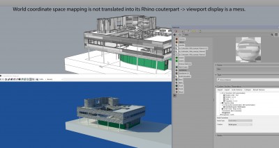

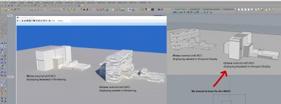

... this would be another old problem... Since World mapping space is also possible in vanilla Rhino this should work I guess...
This one would tremendously help us, since we would not have to apply individual UVW mappings to all new created objects, which is really a PITA (sorry for the bad language ...)
Andy
Can you send me a scene which demonstrates this problem please?
Paul
v-cube
Posts: 495
Joined: Fri Jul 22, 2011 11:02 am
Location: Aachen, Germany
Sure, here you go:
Octane WCS test.zip
(3.94 MiB) Downloaded 273 times
Thanks for looking into this !
Andreas
