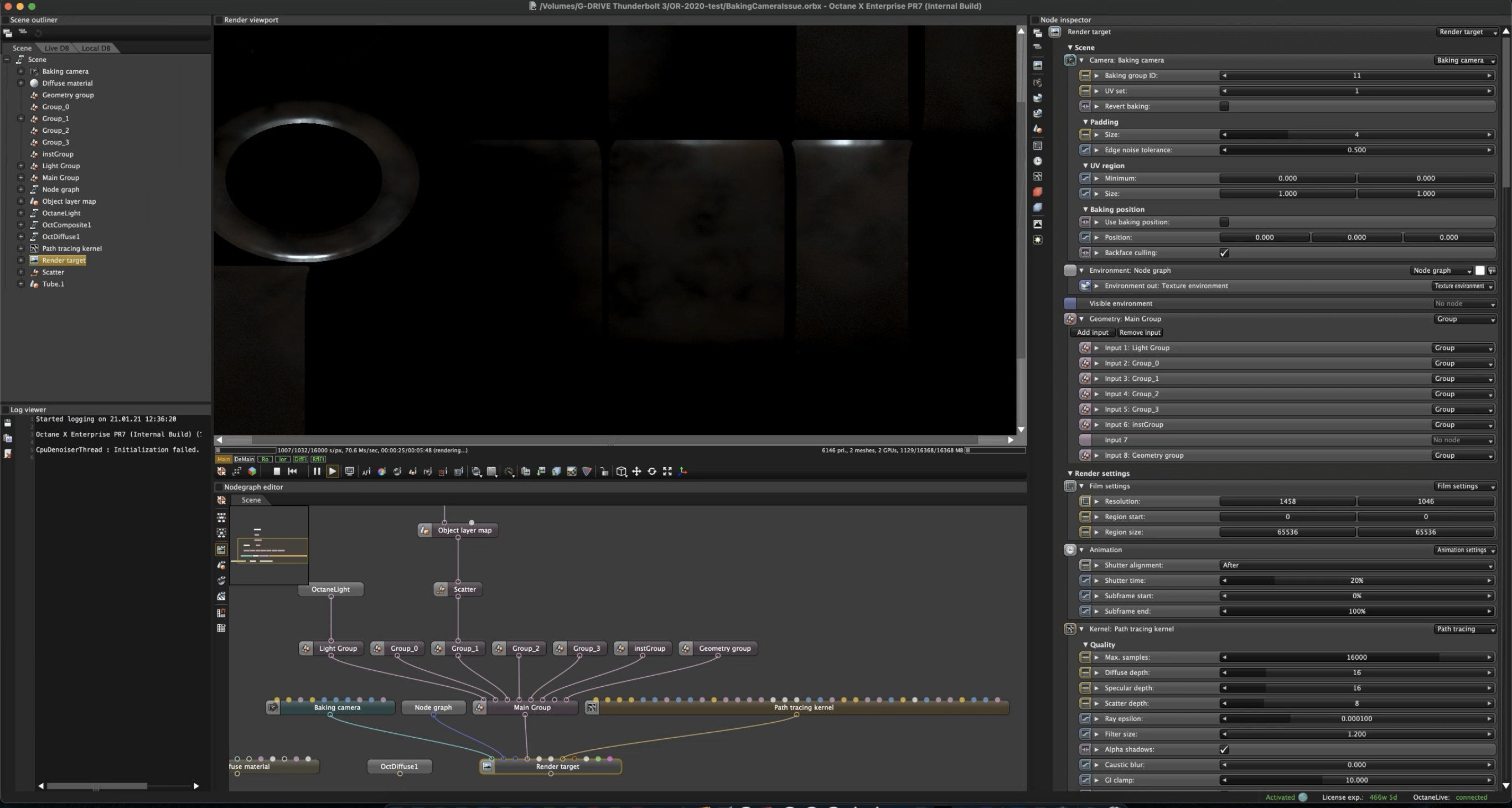

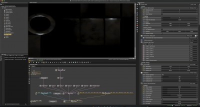

Posts: 10616
Hi Chris,
about Baking Camera, please try with PR7 for Big Sur 11.1, it seems to work correctly here:
ciao Beppe
