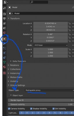

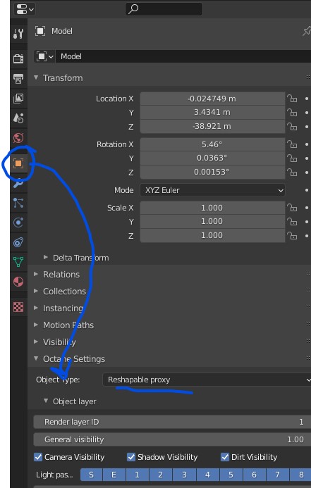

I found it!
The Object Type property has been MOVED from the Object DATA Properties tab as shown in the Blender Octane Manual, and is now in the Object Properties tab, under Octane Settings.
It was set to Auto(Experimental). Changing this to Reshapeable proxy, the file renders out as expected. It's really strange that the deformation animates in the viewport but not the render with the Auto setting. I would think that they should be the same.
