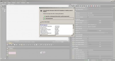

This version crashes in every scene I've tested as soon as it start the denoising.

Zay wrote:This version crashes in every scene I've tested as soon as it start the denoising.
Will look into this immediately in case there was some issue that QA didn’t catch in the deployment, what system/driver config are you on?

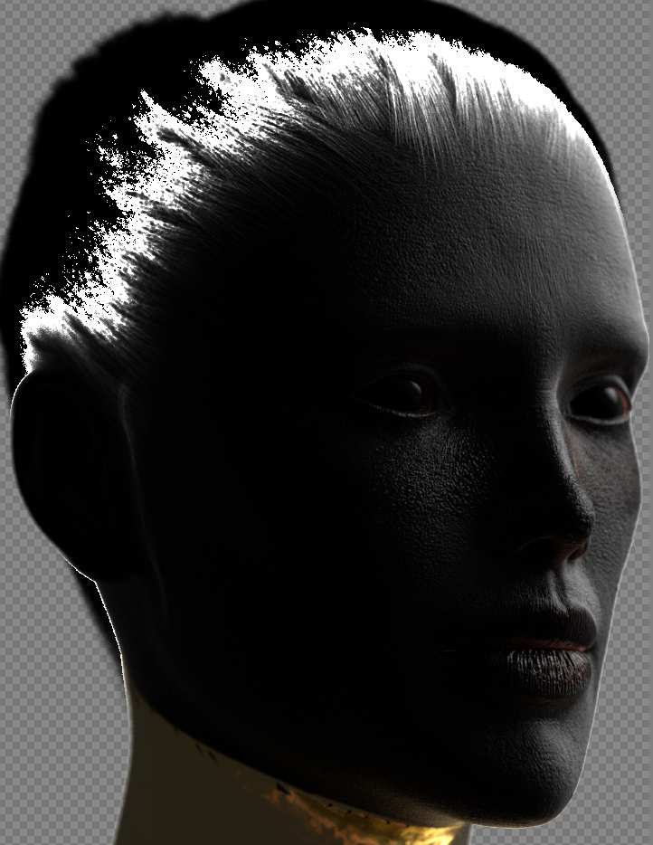

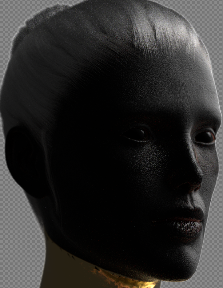

There is something wrong with the Reflection Pass with the Hair Material. Its same in 2020.1.5
Hair Material
Hair Material
Metallic Material
Metallic Material
Win 10 64bit // GTX 4090 + GTX 3090 // 5900x // 64GB // SideFX Houdini // C4D

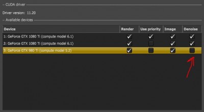

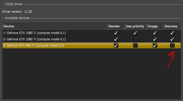

abstrax wrote:EDIT: I just installed driver 460.89 on the Windows 7 PC and the denoiser still works. So no idea what might the problem here.
I did some more tests this morning and think I found the problem. If I disable "Denoising" in preferences for my GTX980Ti GPU, it does not crash. I can render with the GTX980Ti but I can not use it for denoising.
I also installed driver 460.89. Same problem. It will crash if I use all GPUs for denoising. But it renders and denoising fine in previous versions of Octane, so something seems to be changed in this version that breaks denoising for GTX980Ti.
My CPU is i7 3.4GHz 4930K Ivy Bridge-E.

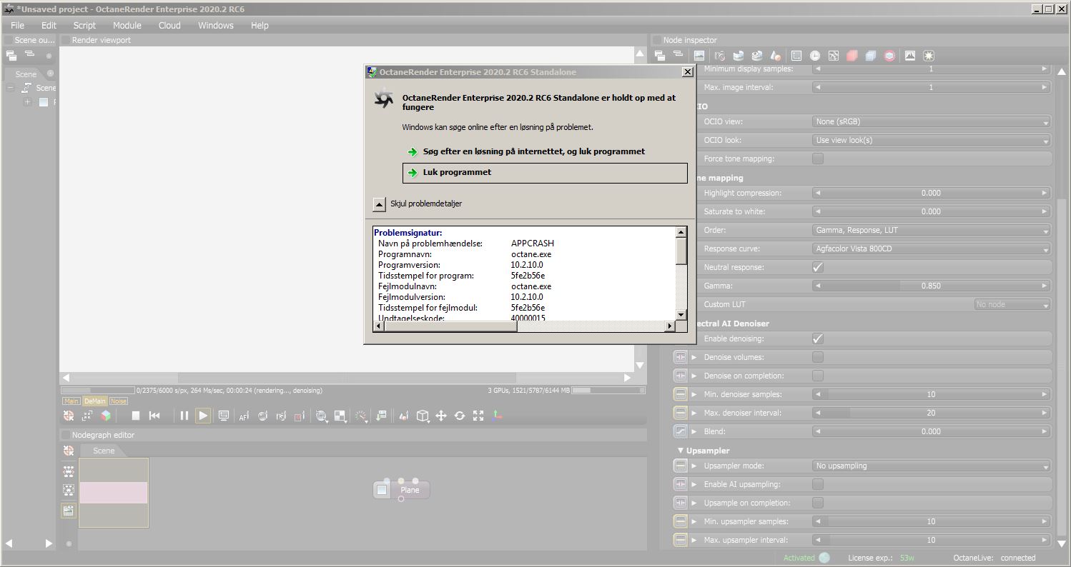

The crash happens at the same time denoising kicks in:
