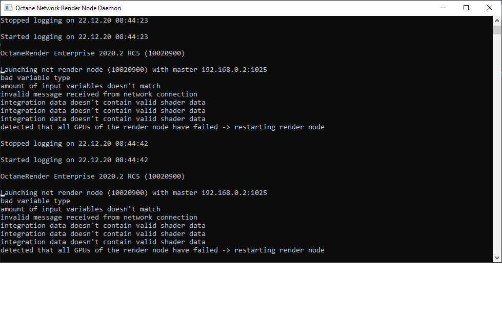

Impossible to render on slave node. What the problem?
Who can I send the test scene to?
Posts: 10635
Hi divasoft,
Net render is working correctly here from both Standalone and plugins:
Please check the scene, maybe you have c4d materials or shaders not converted to octane, that Net render doesn’t like :roll:
ciao Beppe
divasoft
Posts: 349
Joined: Thu Jul 01, 2010 3:59 am
Location: Russia
bepeg4d wrote:Hi divasoft,
ciao Beppe
Yes, there was one standart material in the scene. Thanks for advice.
