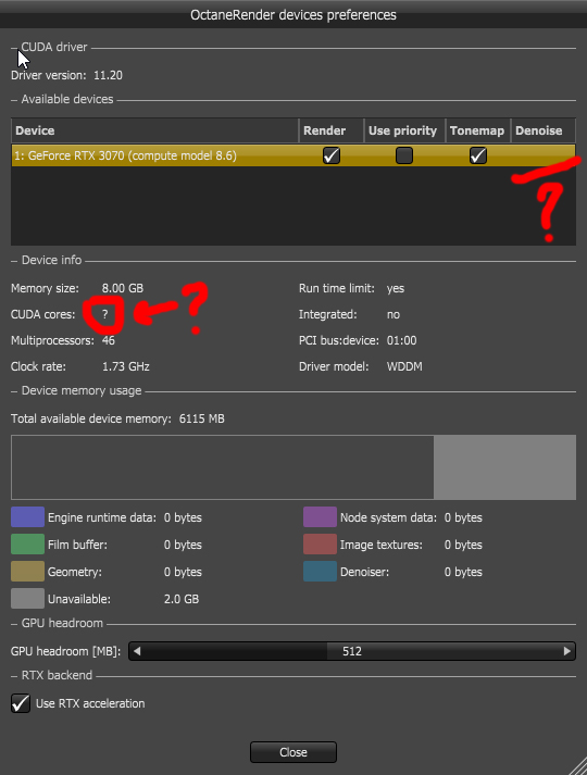

I have a Geforce 3070, Octane 2020.1.5 _-_ 10.20 and Octane Denoiser does not work, it is impossible to specify in the GPU config that the card would process it. I have everything enabled but it seems that when i go into the Octane settings, its unchecked & if i was to check it on, once i close, it unchecks. I read that many on Geforce 30 .. series, Denoise does not work on both Cinema 4D and Houdini
And why doesn't he see CUDA Cores????

Unfortunately last Otane Render plugins and Standalone V2020.1.5 were released before the launch of Nvidia Ampere cards, hence, the denoising is not working.
Denoiser issue was fixed on Standalone v2020.2 build so should be soon for the plugins.
If your scene requires Octane's denoising feature a work around could be use your previous card or export ot Standalone V2020.2 RC5
viewtopic.php?f=33&t=76517

Thank you very much, I will wait)))
