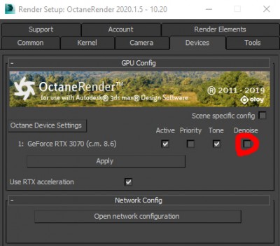

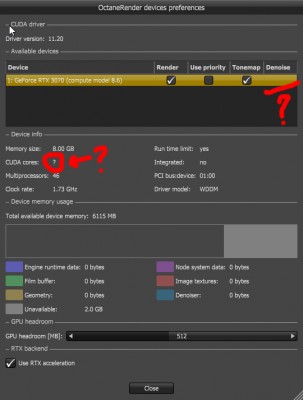

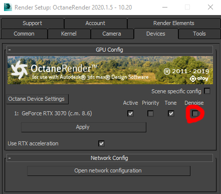

I have a Geforce 3070, Octane 2020.1.5 _-_ 10.20 and Octane Denoiser does not work, it is impossible to specify in the GPU config that the card would process it. I have everything enabled but it seems that when i go into the Octane settings, its unchecked & if i was to check it on, once i close, it unchecks. I read that many on Geforce 30 .. series, Denoise does not work on both Cinema 4D and Houdini
And why doesn't he see CUDA Cores????
Geforce 3070 Octane Denoiser does not work

Hi Templas,
Unfortunately last Otane Render plugins and Standalone V2020.1.5 were released before the launch of Nvidia Ampere cards, hence, the denoising is not working.
Denoiser issue was fixed on Standalone v2020.2 build so should be soon for the plugins.
If your scene requires Octane's denoising feature a work around could be use your previous card or export ot Standalone V2020.2 RC5
viewtopic.php?f=33&t=76517
Regards
Paride

Thank you very much, I will wait)))paride4331 wrote:Hi Templas,
Regards
Paride
