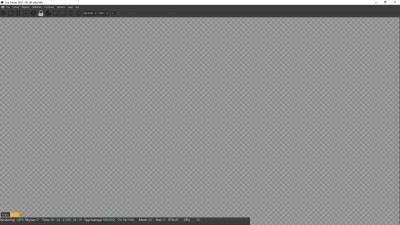

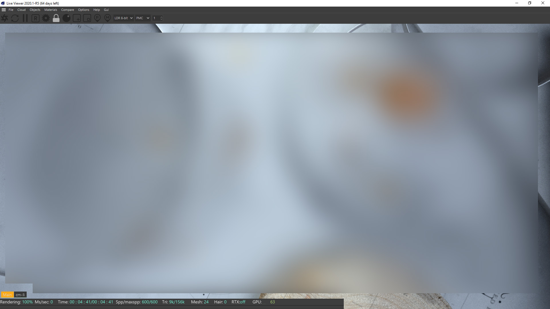

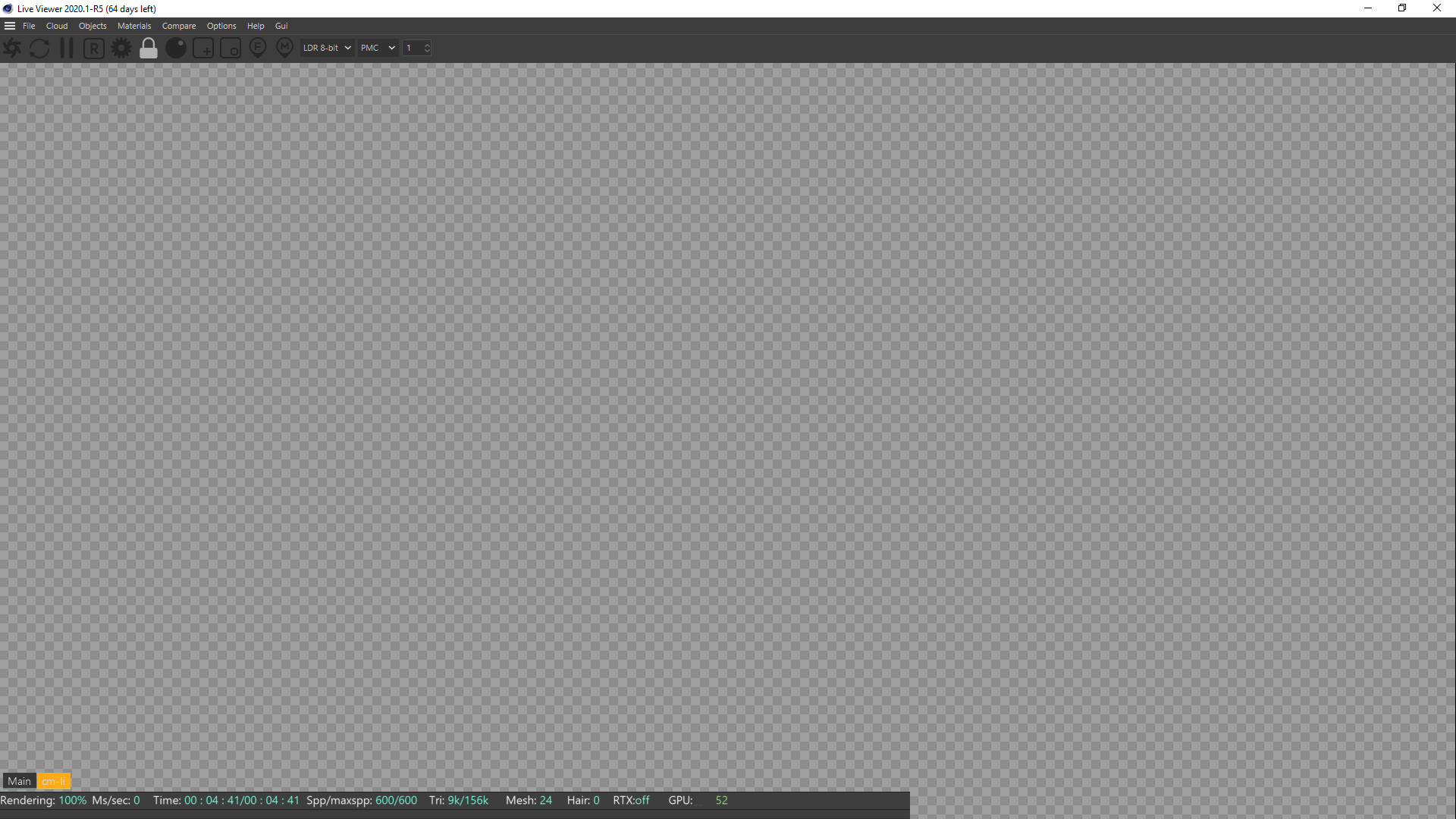

Encountering a scene that is cleaning up very nicely with PMC (same scene simply won't clean up fully within an acceptable time with PT). However my normal comp workflow of rendering an accompanying Cryptomatte pass doesn't seem possible now. Enabling the pass will crash the render as the first frame finishes. In the Live Viewer the pass is visible in the bottom left hand toggles but when clicked and viewed the pass is blank (grabs attached).
I'm trying to figure out if this is a) a solvable issue, b) a bug or c) simply an unsupported feature

Blank Crytomatte pass in LV (Using CryptoInstance but all options produce the same (non) result
Main pass of same render (PMC)

Thanks Beppe, updated from 2020.1-R5 to v2020.1.5-R4 and sadly no joy, Cryptomatte pass still empty in LV when using PMC kernel and crashes render when frames rendered to picture viewer, no issues at all with Path Tracing,

Yes, AI Denoiser is not supported for PMC kernel, and if you export your scene to Standalone, Cryptomatte passes are rendered black, if the Kernel is set to PMC, or InfoChannel.
This kind of issues are not related to plugin, but to the general SDK, I have forwarded your report to the core devs, thanks for pointing it out.
