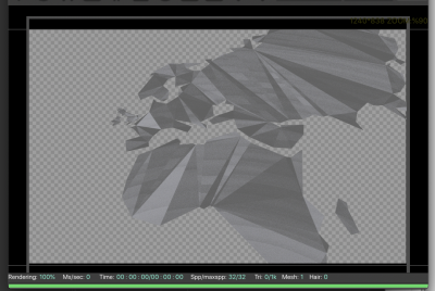

Hi, I am getting very strange distortions on an object when I scale it to enormous sizes. Here is what it renders as at a standard scale:

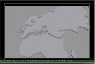

Here is what happens when it's scaled about 1000%:
Any clues why?
I am using R23 with PR5 on a Mac running Catalina

Increase Ray epsilon in Render Settings.

galleon27 wrote:Increase Ray epsilon in Render Settings.
Great, that worked, thanks!
Changed fro 0.0001 to 0.001.
