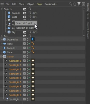

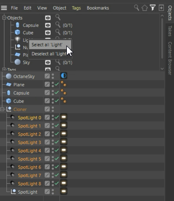

About Sample Rate in lights, in Standalone you should need a Lua script for that, while in an integrated plugin it should be easy to filter select all the lights in one go, and easily change the Sample Rate to all of them with a couple of clicks:
