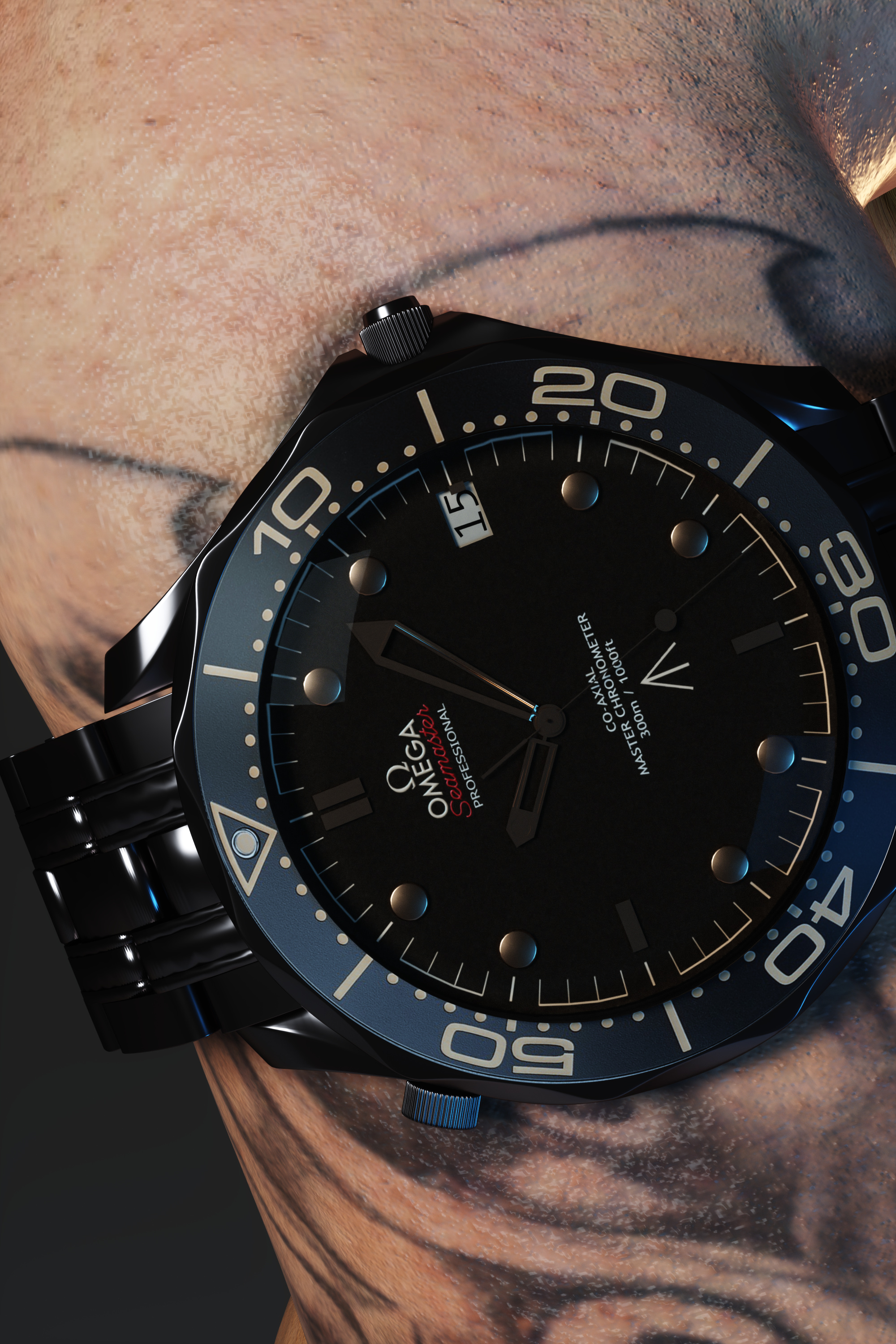

Hi .. I've seen this a few times where certain objects in DAZ window are NOT shown where they should be. I have a feeling this is due to Octane not reading DAZ's Scale, rotation and location correctly. It doesn't happen often but every now and then this happens and it's a pain in the arse.

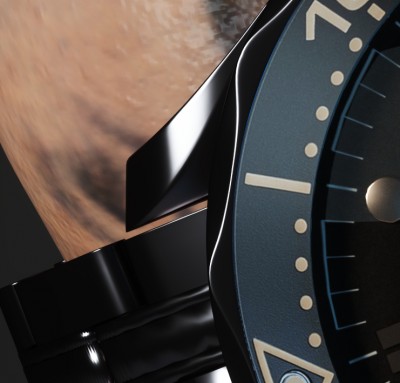

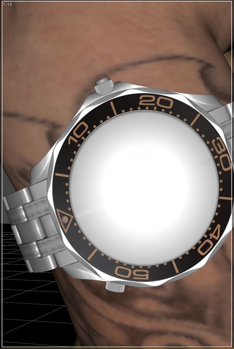

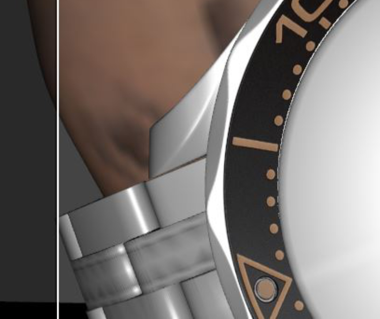

Here's an example. The crown of this watch is squashed a bit and offset to the right .. also the helium escape valve crown (bottom left) is clearly a millimeter or two lower than it should be .. and there's a distinct gap between the bracelet and the top left lug of the watch case. Compare to the DAZ window you'll see what I mean.
I realize these are tiny defects .. but this has happened with bigger objects not showing up where they should. In most cases these objects are parented to a person who has been scaled or changed .. and the watch itself has been scaled in order to fit the wrist, and sometimes stretched. But regardless of that .. if it looks okay in the DAZ window .. WHY? .. is not the same as in the Octane window? Is there any way to sort out these positions of objects just rendering in Octane wherever they want?

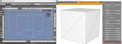

I think the geometry in octane is different than that in Daz. I think they apply some kind of vertices optimization (convert to triangles) that does change things a bit.
Here is a simple scene with a cube displayed in Daz Viewport and Octane Viewport as a Wireframce. You can see Daz is using Quads, while Octane is using Triangles. To see the Wireframe of the scene under Octane, in the Octane Viewport, under Render Passes, scroll down until you see Wireframe - OFF. You can click on it to see how Octane is treating the geometry. It will create the wireframe render pass that you can switch to to see the wireframe (Title Wire).
Subdivision / rounding / smoothing of things do tend to look different in Daz and Octane. That is what I have noticed. But as I only look at the Octane output, I don't bother with how it looks under Daz.

Geometry needs to be converted to something the GPU understands. And that is triangles.rajib wrote:I think the geometry in octane is different than that in Daz.
