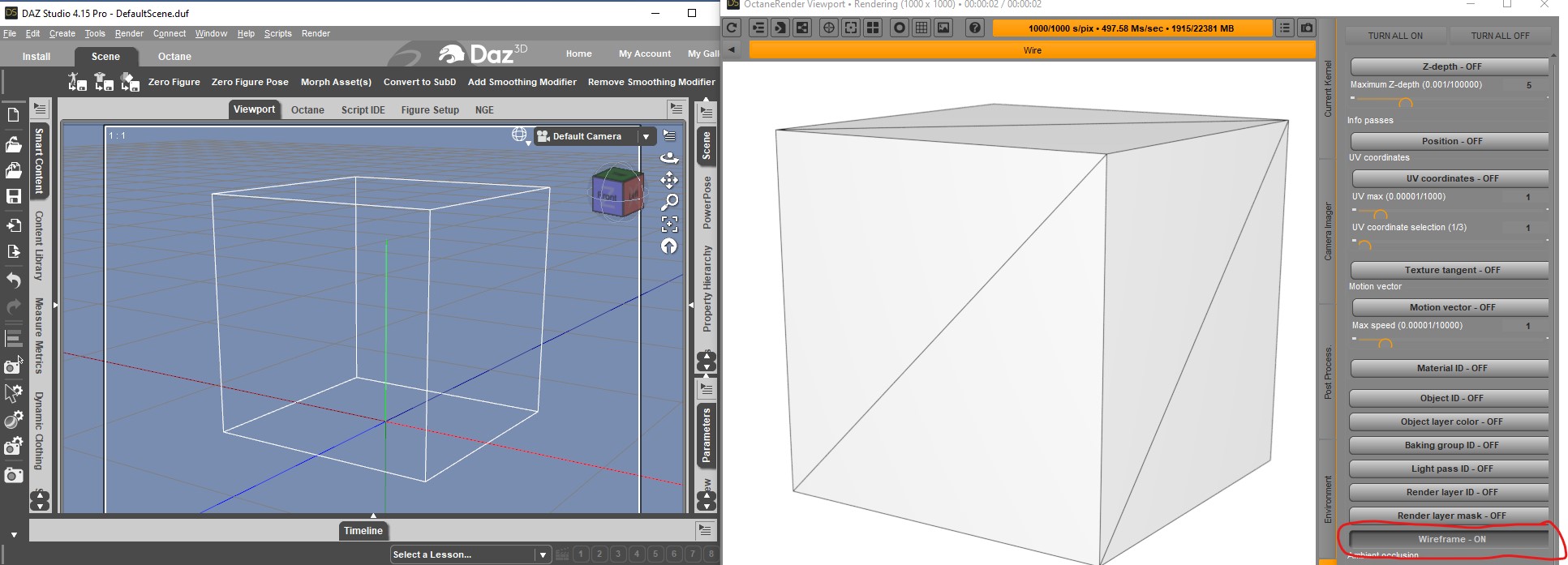

I think the geometry in octane is different than that in Daz. I think they apply some kind of vertices optimization (convert to triangles) that does change things a bit.
Here is a simple scene with a cube displayed in Daz Viewport and Octane Viewport as a Wireframce. You can see Daz is using Quads, while Octane is using Triangles.
Daz vs Octane
Daz vs Octane
To see the Wireframe of the scene under Octane, in the Octane Viewport, under Render Passes, scroll down until you see Wireframe - OFF. You can click on it to see how Octane is treating the geometry. It will create the wireframe render pass that you can switch to to see the wireframe (Title Wire).
Subdivision / rounding / smoothing of things do tend to look different in Daz and Octane. That is what I have noticed. But as I only look at the Octane output, I don't bother with how it looks under Daz.
