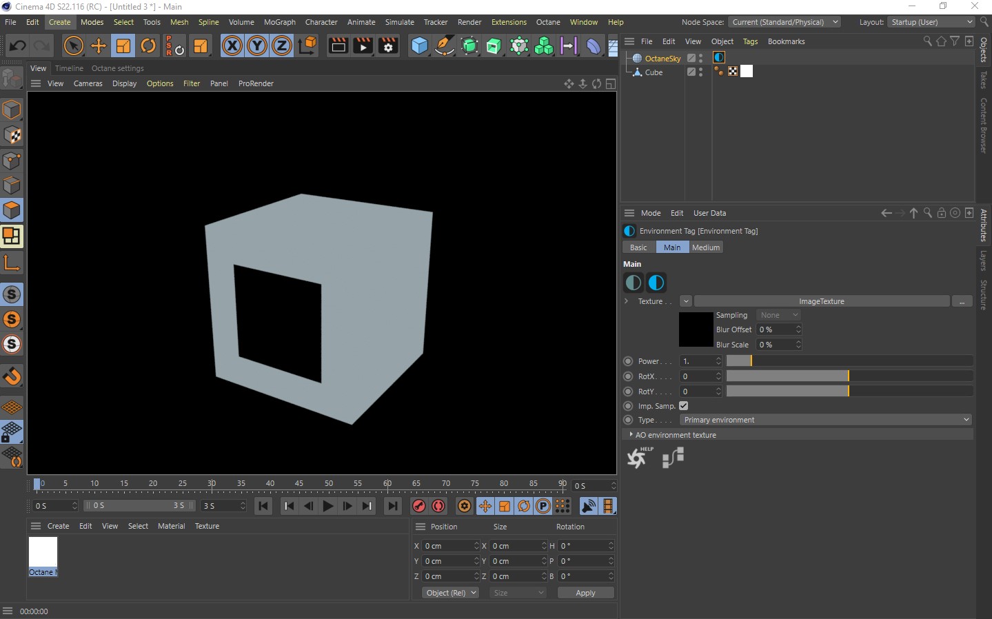

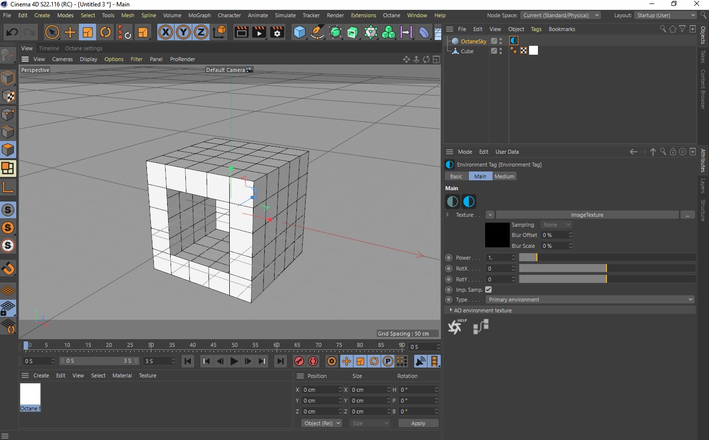

I try to have a material inside a surface (cube) but i can't get how to do it.
Here some captures.
Could you help me to solve this please ?

Looks like you are using an Emission material and your polygon normals, the ones inside the cube, are probably facing the wrong direction.

How can i change polygon facing direction, please ?

hi,
polygon selected > right click > reverse normal

Also, an easy way to see what's up with surface normals is using either
panel menu/Options/Polygon Normals, and select the faces in question
or render with
Octane Info Channels Kernel/Shading Normals
