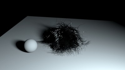

Thank you BK.
it's not really visible on your scene, but we can see some strong specular. They look ok here, because of the strong sky ilumination and the form of the hair.
Look at know with a low light and some brushed hair. The specular are really too strong, and if i change the roughness, the hair will become grey.
sorry for my terrible english...
M.°

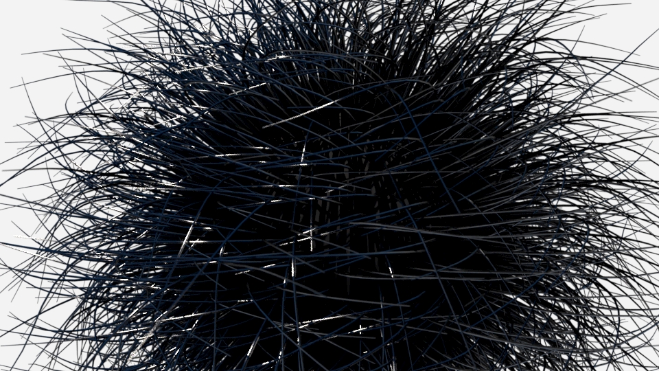

we had a quick look and it seems the over highlight issue is to do with light intensity.
Please take the `Power` value down to 3 - 4 or move away from the hair.
Also, to correctly calibrate the light please apply Octane Hair, Glossy or Specular material on the sphere geo to compare.
Attaching a quick sample using `Albedo` and the `Melanin + PheoMelanin` workflow for reference.

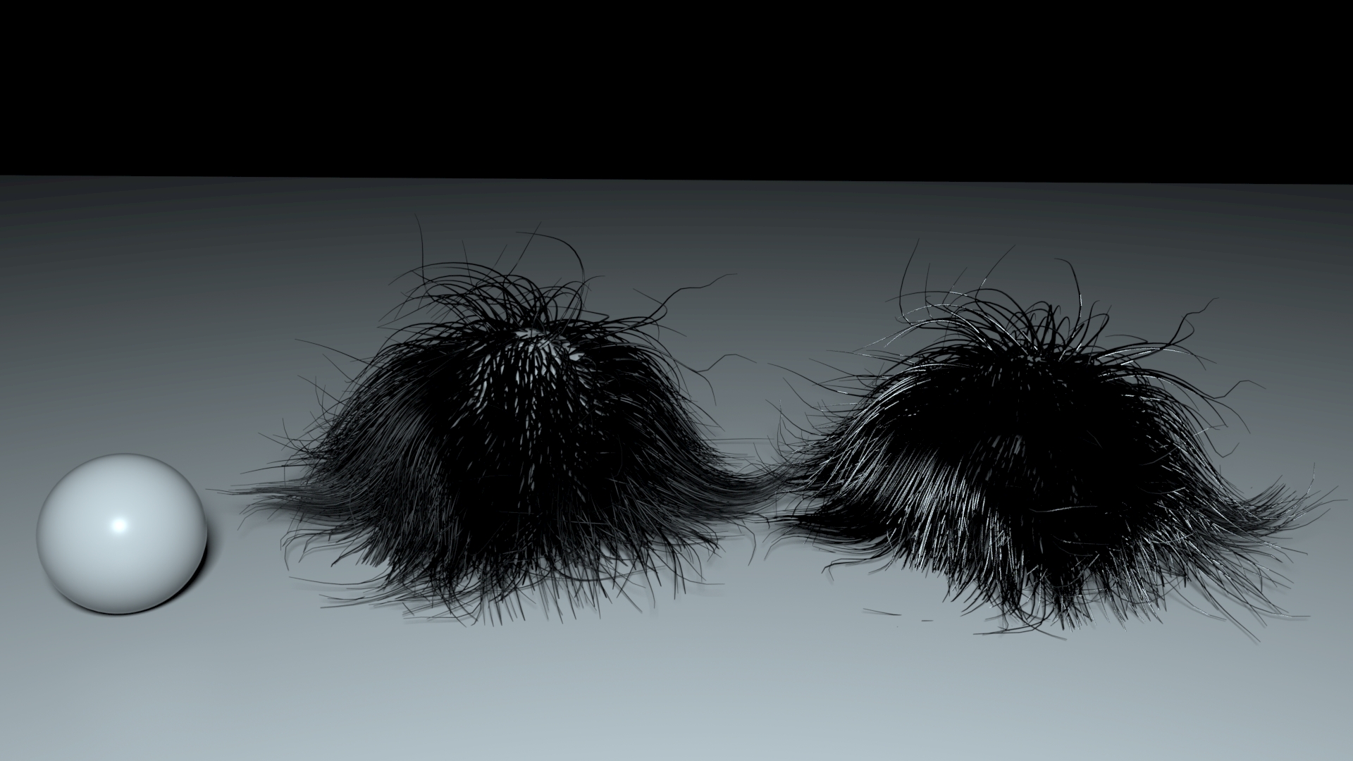

Hello
i put the same glossy Material to spheres, plane and Left hair (i changed the color for this one).
The right hair is the Octane Hair material.
the light is at power 3.
it's not a light intensity issue, imo.
M.°

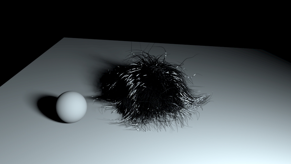

Hi M,
Thank you again!!
Could you please try this attached file and let us know if this is the expected result you are after?
