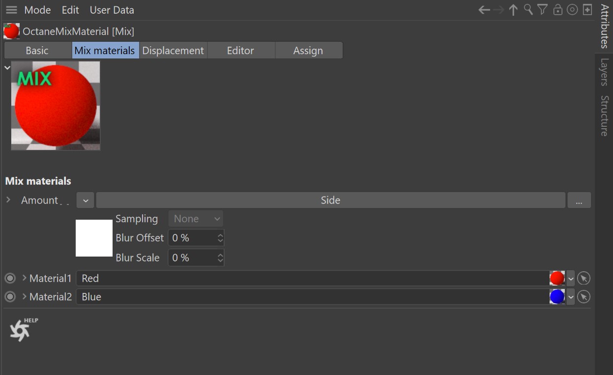

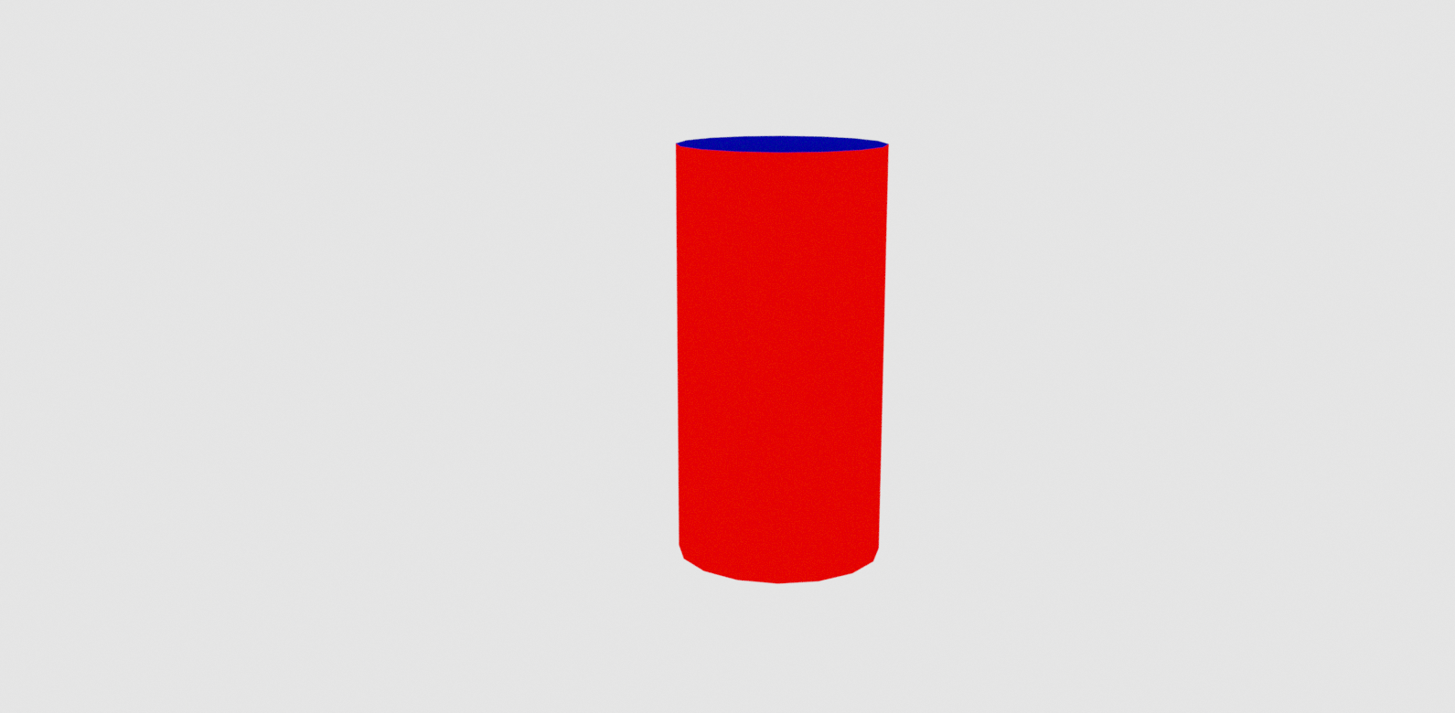

I tried this with a plane and it worked, but I could not get it to work with a cylinder. This method is projecting to the opposite side of the polygon face rather than the object.
Mix Material
Mix Material
Result
Result

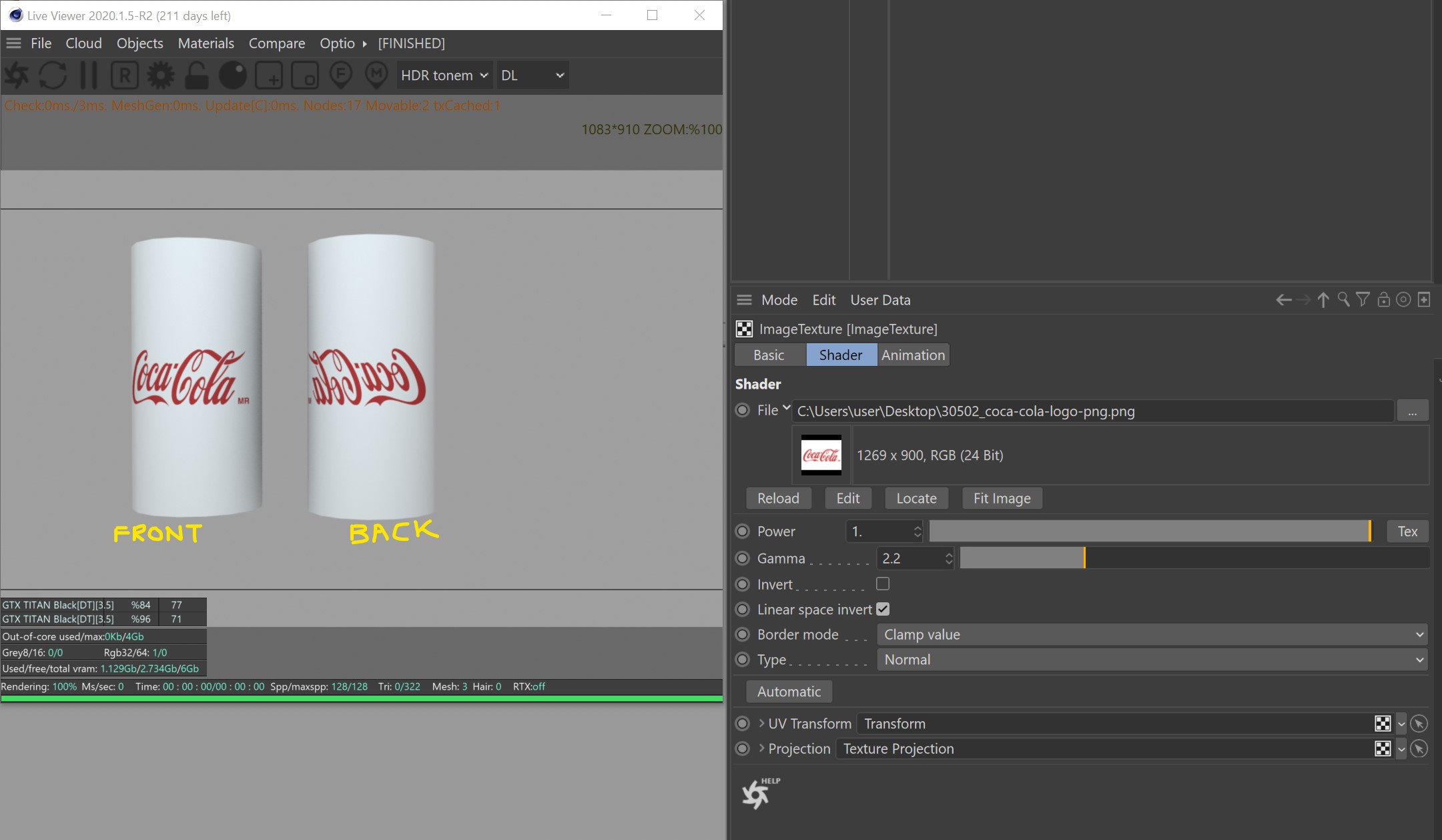

Desired Result
Desired Result
Here is my Cinema 4D scene file.
Can it be projected to the opposite side of the object with flat projection? Thank you.
* note: With native C4D texture tags, the Flat projection can be split between two materials by rotating the Flat plane's coordinates by 180 degrees.

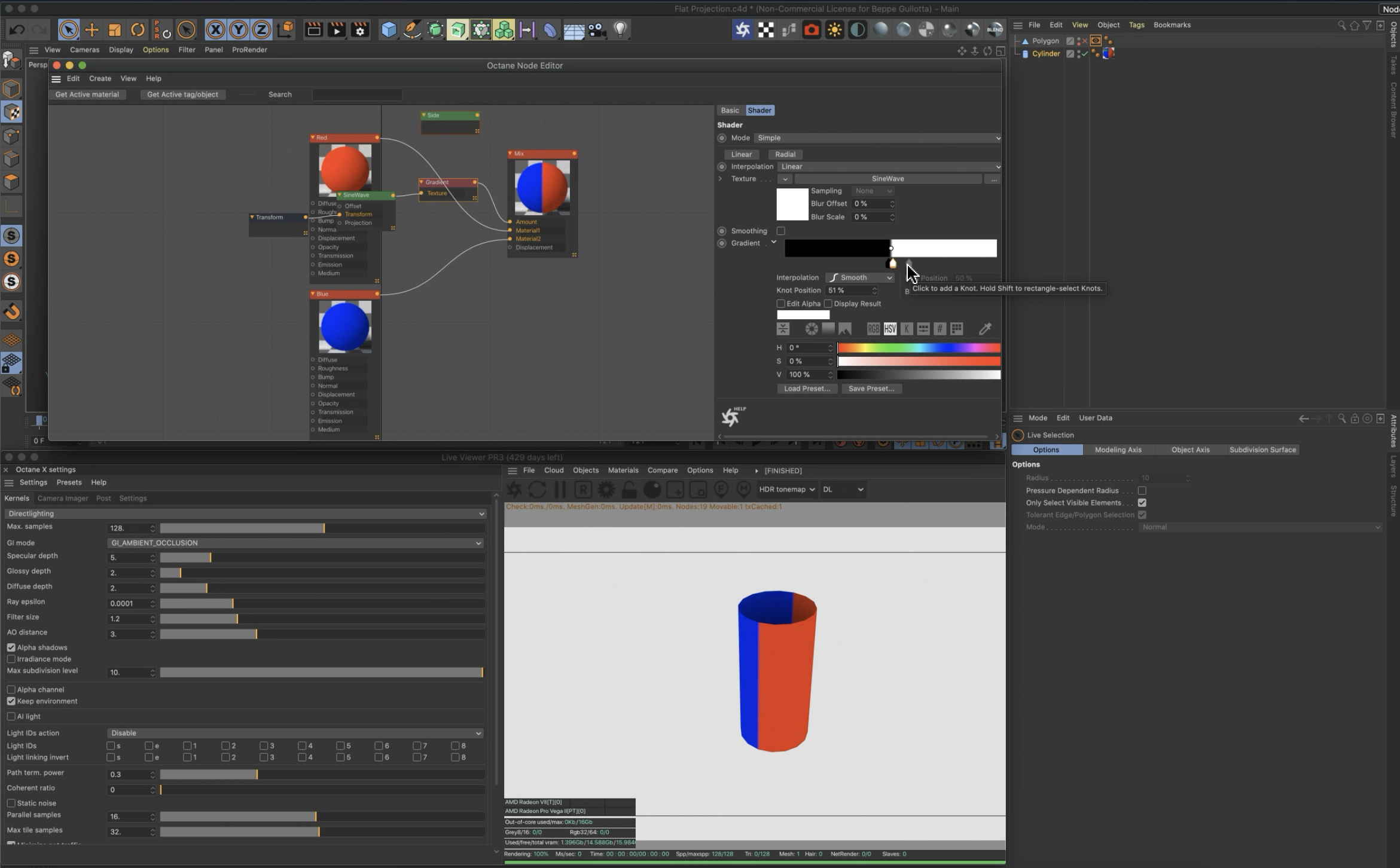

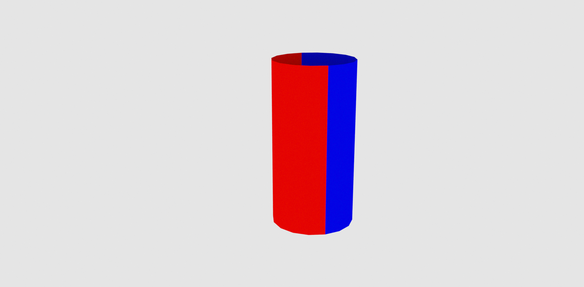

here is a different approach, instead of using a Side node, I have used an Octane Gradient node, but with Black and white handles very close to the middle:
Flat Projection_b.c4d.zip
(66.91 KiB) Downloaded 185 times
ciao Beppe
