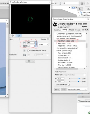

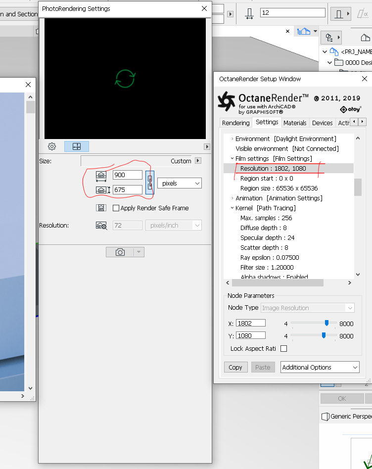

is there a simple way to do this? I've had a look through the settings but AFAICT you have to manually set the resolution in the camera 'Film' settings.

Hi - if you do a Photorender using the OctaneRender renderer, the resolution should automatically match.

thanks for the reply.
how about with the pop up render window? i usually use this window while working - should i be using the main render window?

The OctaneRender Viewport (ie. NOT the Photorendered) cannot access the Photorenderer setting (like resolution), since the ArchiCAD SDK isolates the Photorenderer functions from the rest of the API. So I don't think this would be possible.
