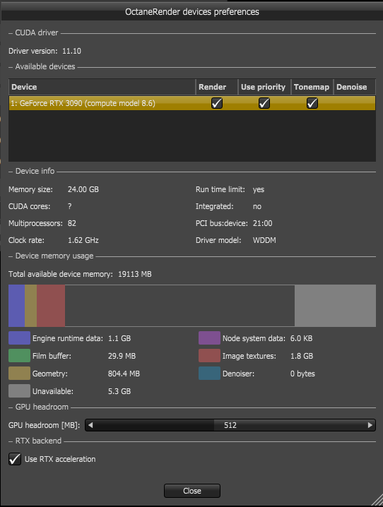

I put a new single 3090 in my pc and the denoise option seems to be down (image attached). Was previously rendering this scene with denoise on when the machine had x2 2080 ti's but now it just hangs on the first frame after rendering, unable to complete the denoise pass. Most recent (game ready, 456.55) driver installed.
Does denoiser require multiple gpu's, or is this possibly a bug with the new card?

unfortunately v2020.1.5 has been published before RTX 3090 was available, so you have to wait the next 2020.1.6 SDK update to have the first version supporting RTX 3090, I’m sorry.

Because supporting sdk is 2020.2 and it has serious revisions. Especially for color management and AOVs. And I'm on that to revise a lot of parts and it's not safe to use yet for any production.
