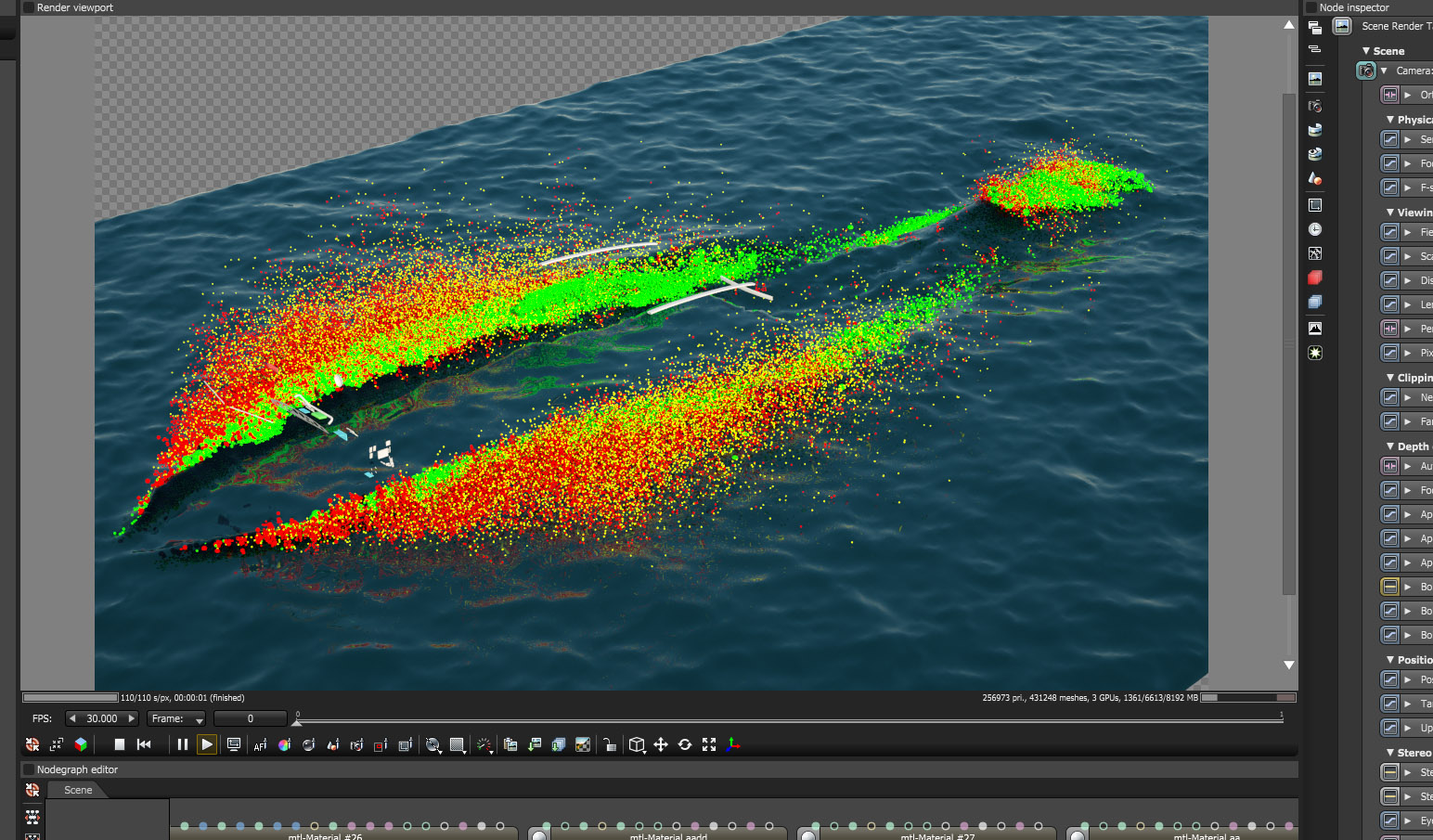

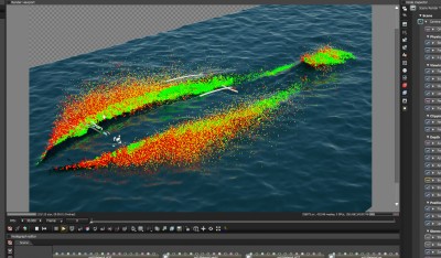

Well, the .ORBX doesn't load .AUR particles (foam and splashes) in the standalone, I guess it's because .AUR is a chaosgroup file format..
My diffuclty is that I can't save my particles in .VDB, simulation doesn't work and I don't know why (Phoenix FD issue for that part), so I'm stuck
