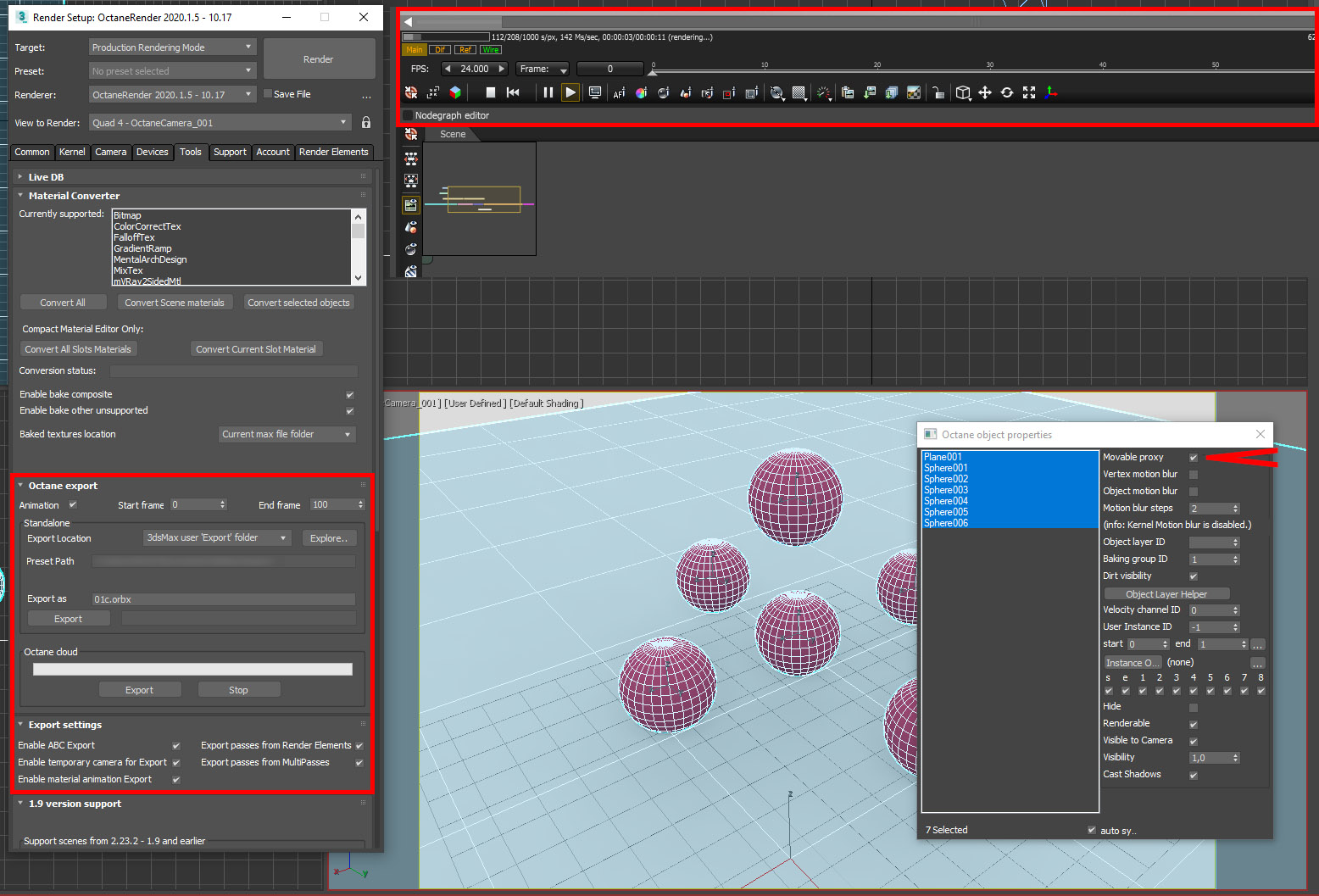

I've set up a scene with Octane cameras that are animated over 100 frames. I export the scene from 3ds Max, using the Octane Export tools and checking the "Animation" box.
However, when I open the exported scene in standalone, there are no options to go to any frames and I only see one frame of the camera.
Am I missing something? There seems to be no documentation or tutorials on this process.

Hi Samuel,
I hope it helps.
Regards
Paride

I've added the moveable proxy to all objects, whether they moved or not. Then re-exported with a new name and it worked!!
Thanks Paride!
