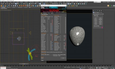

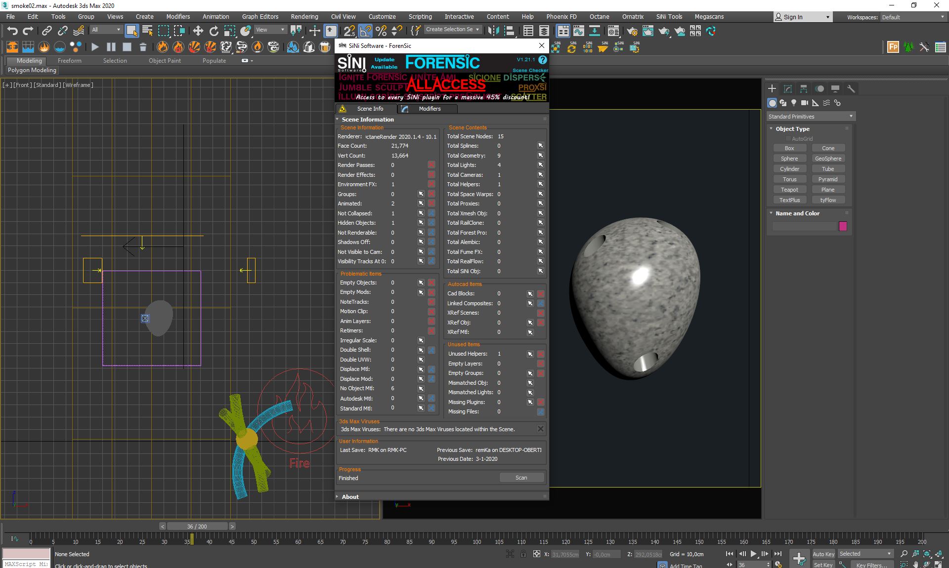

Hi,remKa wrote:Hello Paride,
no I didn't, they are created when I press "Open Octane Viewport"
The more I increase the grid resolution, the more omni lights are created... no issue with liquid simulation, just with the fire simulation
could you try to take a look at here please:
https://forums.autodesk.com/t5/3ds-max- ... -p/8330950
Regards
Paride

Hi remka,remKa wrote:No virus so far !
could you share your issued scene (in pm if you want) please?
Regards
Paride
Yes ! Check your inbox

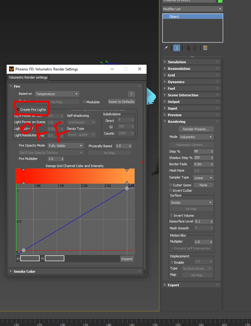

here is my post from a long time ago where 3ds max creates 500 omni lights
viewtopic.php?f=80&t=71441&p=363956&hil ... ts#p363956
I still don't know why. Having viewport opened with phoenix fire in the scene and then dragging timeline will usually create 500 lights. Maybe something to do with Fire Lights. Make sure they are off otherwise using multiple phoenix grids will make your eval times go up a lot.
