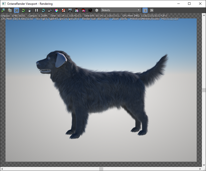

I tried movable proxy and disabled RTX and NVLink. And YEAH! Now I see the dog in IPR, but it is so laggy... We should fix this too in the next build.
And yeah, when I turned on "Movable" proxy for the all objects - ORBX was exported without any error.
Then I tried to import this ORBX to the scene and render. =)
And YEAH! It working, but viewport still laggy without RTX and NVLINK.
Then I tried to turn on the RTX and NVLINK, and yeah! The viewport is very fast and NVLINK helped to work without "Out of Core". I disabled it in this scene and saw P2P - 4Gb. So, as I understand, this scene need 16GB VideoRam and NVLink helped in this case.
And 128 GB SSD Virtual Ram Helped me to render without OOC and CUDA Errors with RTX ON.
YEAH! Horray. Thank you for your help!
Video with laggy viewport without RTX and NVLINK and all my tests - https://www.youtube.com/watch?v=mzm_xWr ... e=youtu.be
ORBX file for tests -> https://bit.ly/2CS5j28
So, the solution in my case is:
1. Virtual memory on SSD - 128GB
2. Turn on "movable proxy" for all scene objects. (Octane object properties, select all, turn on Movable proxy)
3. Export to ORBx proxy and import it to the new scene
4. To speed up the viewport "RTX ON", NVLINK ON (peer to peer in Device settings)
5. Parallel samples = max, Max Samples = max.
6. Disable "Out of Core", because 2x2080Ti is enough for this scene (P2P - 4GB) =)
7. GPU HeadRoom - 1024MB
Done =)
Thank you and have a great day
Best regards,
Andrew.

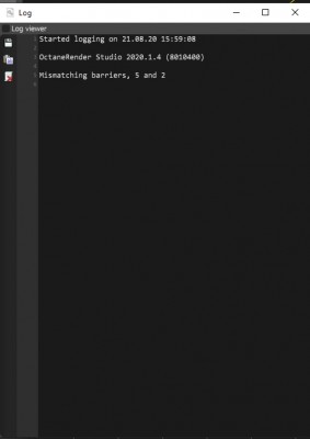

But sometimes, without ORBx in a main scene - IPR closed and I saw this:
Last edited by andrey.krivulya on Fri Aug 21, 2020 4:32 pm, edited 1 time in total.

Hi, dear OTOY developers
So, I tried to catch this issue and recorded a video. In the end, you will see it... Sometimes it happens when I change the resolution and sometimes - when I just rotate camera =) Sometimes when just start an IPR =)
Video with the issue -> https://www.youtube.com/watch?v=z7_X_kTdLcM
The scene for investigation -> https://bit.ly/31hDt8T
Best regards,
Andrew.
